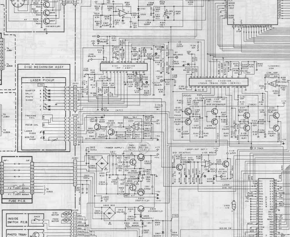

I would like to tweak the laser servo circuitry in my Nak CD-Player.
The unit (OMS-5II/7II) is now 19 years old and error correction is not good, even though I swapped the laser 3 years ago and aligned it perfectly. 0.3mm is the barrier (scratch width) where one hears clicks and the laser starts to skip.
Any modern unit will easily go up to 1mm.
There are three opamps used in the servo circuitry, M5218A, which were also often used for audio signals.
What could be a replacement? Would a faster slew rate help the circuit to react to scratches much faster?

Unlikely, concealment and error correction are a function of the complexity (cost point) of the player's digital signal processing chipset, not the analog servo circuitry..
Take better care of your disks if possible or find a player that handles the errors so generated..
My Shigaclone is not great in this respect either, but I like its performance otherwise and live with the occasional skip which is actually rather rare - only happening with a few of my wife's disks which have not been well treated.
Hello Kevin,
no, I am talkung about the analog circuitry which keeps the laser on track and reacts to scratches. Not interpolation. I have attached the circuitry.
All the best,
Salar

Hi Salar,
I'm afraid it wont help at all, swapping the I/C's. This is one area of performance that has greatly improved since the first generation players.
If I mention Nyquist stability, we think of amplifiers and feedback. The same problems exist here but with the additional complexity of a "mechanical/inductive" component in the loop-- the tracking and focus coils. The characteristics of the "analogue" stage are carefully designed and very critical. Careful setup can help, particularly EF balance if the player has an adjustment for it and focus bias.
You would have to follow the manual, but I think you have done this already.

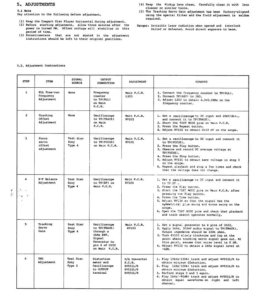

Highspeed, do you still remember setting the E-F balance of the OMS?

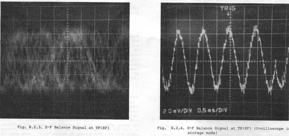

I am using the YEDS-18 Test disc for this. But the E-F Signal does not look as clean in real live as it is shown in the service manual.
In test mode with the spinning YEDS-18, it E-F resembles a sine wave, which has to be adjusted to swing equally around 0VDC.
But no matter how correct I adjust it, (or how much it is out of adjustment) it changes frequency and amplitude randomly very fast (but can somehow be adjusted around 0V)
Thus effect was also before any mods and with the old laser, so this is normal behaviour?
The eyepattern does not look very clean, also no matter what laser. But I do not know wether I should expect a clean eyepattern because it is not documented in the service manual. Strange, because this is the first thing one should look at.
The lines are not sharp, the outer edges are blurred and noisy. Checked it on two scopes.
To make the nak safely play CDRs, focus offset has to be raised a bit, this also raises the amplitude of the eyepattern.
I spent many days with adjustment, also with tracking/servo gain and Dropout detection circuit, but 0.3mm is the barrier...
I attached a photo of E-F balance from the service manual. Maybe they used an external trigger to make the waveform look stable?

When using scope make sure you use the correct grounds as this can make the also RF look noisy. The eye pattern should ( not all players achieve this ) be very sharp and well defined. The diamond shape should be "steady" , any slow vertical bounce in the waveform indicates that the turntable is not true and that there is an up/down motion as the disc rotates. Check by looking at the outer edge of disc and turn slowly by hand.
The EF balance will be correct if it is symetrical about zero. Can be useful to adjust/check while repeatedly using track search and slow search I use to find on some players. Try it ? Can you feel any play in the spindle motor bearing.

You need the ground that the RF amp uses ( as close to the rf amp ic as possible ) and to measure the RF as close as possible to the output of that amplifier. This does make a huge difference to how clean the signal appears in a lot of cases. Focus bias will affect the clarity of the eye pattern. If you connect probe tip and ground lead together on the scope and then touch both these to the chassis does the trace on the scope thicken due to noise ? If it does try a 10 ohm in the ground lead to the scope probe.
EF balance. Going from memory now, but try AC coupling the scope, and doing track searches while looking at the EF error waveform. As you keep doing this switch the scope back and forth between AC and DC coupling and try and get it so there is no shift as you do this. Long time is I have done one, but it should be fairly clear where the correct setting is.
Edit, ground = pin 7 of RF amp and use the designated EFM testpoint. The CX20108/9 chipset is nearly first generation and is the same as the original Sony D50 Discman (The first ever).

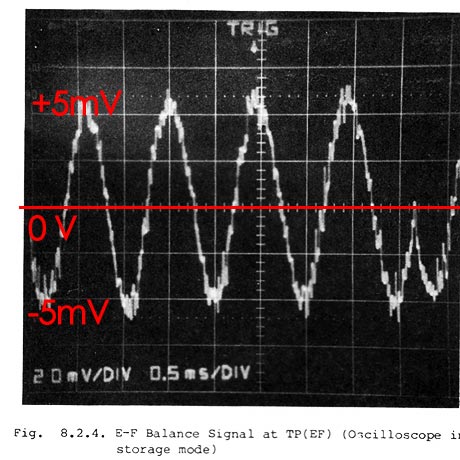

So E-F should look like in the attachment of this post?
Never tried to measure close to the RF- amp, I am curious to do so, but it will take some weeks until I have the time to do it.
When I measured E-F balance , i first short circuited probe to ground (DC coupled) centered the flat line as reference on thze scope and then started measuring.

That looks fine. As you turn the pot you will see the waveform shift and become non symetrical. It shows up more if I remember in track search. Oh by the way, Iv'e never worked on a Nak CPD. Worked on loads of Sonys, the D50 used the CX20108 etc. We used to sell a Fidelity player that was based on this chipset and these were always failing (the 20108). Changed probably around 6 to 8 altogether, never once on any other make of player. Must have been some PSU problem or spike seeing them off.
As for the other adjustments, as I say I don't think you will improve it a lot. For tracking gain connect scope to the tracking error waveform testpoint and as you turn up the gain a low frequency component will begin to appear in the waveform -- try it -- you want to back off slightly from this point so the fundamental just dissappears. Thats about it really :)
