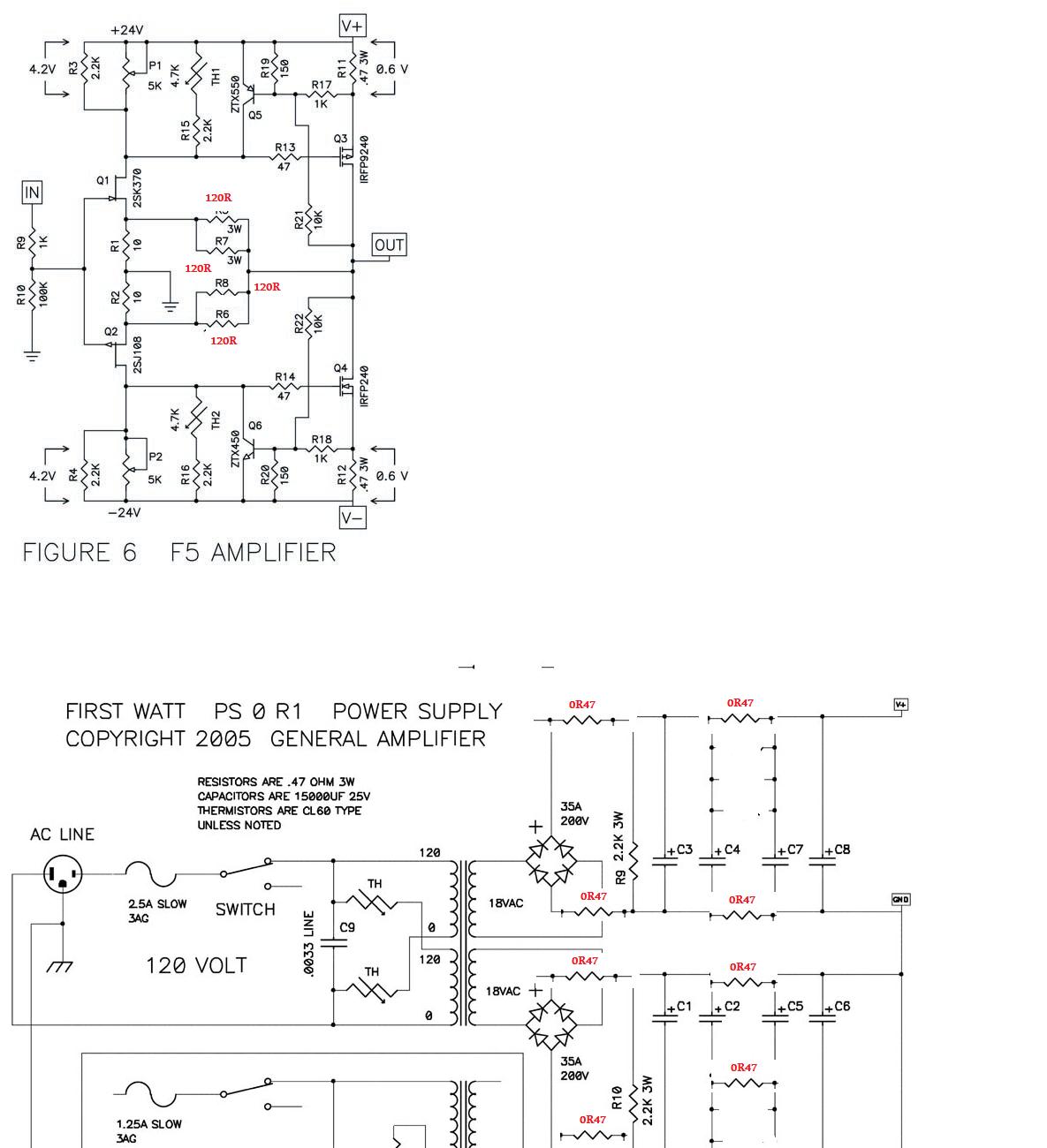

Hi.My transformer is 600VA when regulated with capacitors it is +-22 volts.And after 0.47R resistors it makes about 21.3 volts.Idle current is about 1.5amps.I am using 4ohm nokia 18cm 90dB woofers and westra 94db tweeters.I think i should decrease the V supply by resistors RCRC filter to +-17volts and increase bias to about 2 amps to get more class A sound.I will use 2sk1530/2j201..I should change some component values I think.My redesigning will be like this picture below.what do you think about my idea?

I think i should increase bias to 2amps to get more class A.I want to increase more but transistor power area does not allow more dissipation.I think 2amps +-18volts are ideal.
I dont know how much bias it would take to make a classA 20watt(8ohm) do at least 30watt class into 4ohm
30W Class A in 4 Ohm is 2.75A current, peak current is sqrt(2) times higher, ~ 3.9A.
In a push-pull output stage that's 1.95A quiescent current, regardless of rail voltage level.
(the 20W/8 Lang MOSFET amp design from the early 1980s was set up to run Full Class A in 4 Ohm, 2A bias and output stage rails of +/-20Vdc, for a single pair of Hitachi TO3 Mosfets)
