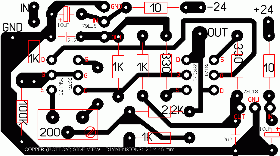

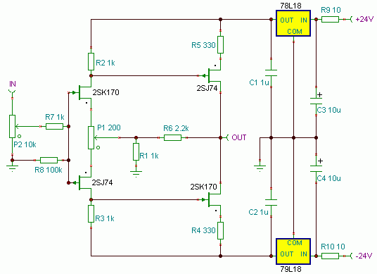

The one I attached will do nicely - it sounds very good and it's easy to build. F5 is very light load (100k).
R6/R1 ratio sets the gain (make them both 1k for the gain of 2V/V or 6 dB) and P1 sets the DC offset on output.
You can use F5's PS to make a regulated PS for this preamp.
Input pair of K170/J74 can be GR or BL ; output ones are BL or V.

If one needs no additional gain, I personally would just put an attenuator (or passive preamp, or whatever else you want to call it) right at the input of the F5, driven directly from the CD player. With 101k input resistance, there is no real need of a buffer stage if you use a 10k attneuator (which an avergae CD player will drive easily) and no long cables in between).
BUT personally taste. Everyone is entitled to choose his own favoured solution.
Patrick

Sorry lineup, but I can not be credited for that circuit. I found it in one of the articles published on E. Borbely's site and it seemed to me a right preamp for F5. Most important drawback of this preamp is its inability to drive very low impedances, but it won't be the problem with F5 (101 k Zin). It produces 5V output (peak) with ease and it sounds lovely (no change in F5's sound character, only higher output) - that's all I need :)

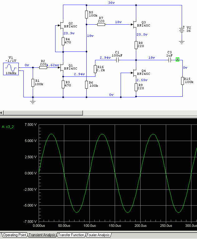

Here is another idea that I've been playing with. It's based on J. Broskie's Aikido tube design. I used FETs that are cheap and abundant. Recorded values from simulation software are pretty much consistent with real life circuit (it's often true for simple circuits).
By listening to it I cannot find a fault, but it has certain drawbacks from designer's point of view:
- higher PS voltage (must be derived from separate transformer or by means of voltage doubler from F5's transformer)
- PS voltage must be very clean
- design uses a couple of coupling caps
OTOH, it's simple, easy to build, no hard to find parts, highly customizable (use of other FETs possible), no P-channel FETs needed, and IMHO, it sounds good :)
use fb arrangement as in inverted OP amp , then you'll loose one cap ;
