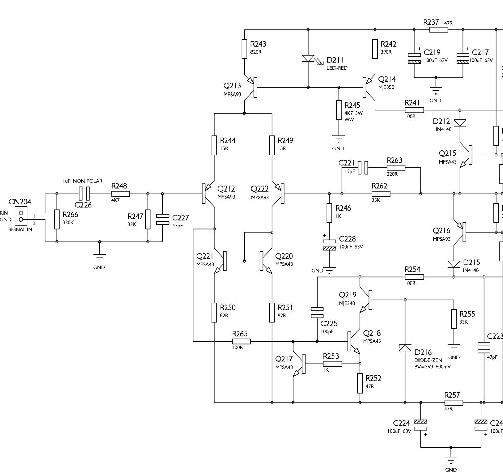

Hi all,
I have a Cambridge Audio A5 amplifier that has a fried SAP15 transistor. I took it to richer sounds to get repaired but they want £80 to do the job, unfortunately I don't have that money so I'm looking at repairing it myself. I can use a soldering iron fine but I was hoping anyone with experience of this could tell me if any other components are likely to be broken too, and also where I could source the SAP15 transistors from. I checked rapid electronics but they only have SAP16.
Theres a pic for you to take a look at if it helps.
Thanks loads!
ok, first of all you really need check if there is any evidence of burning around any resistors then replace both positive and negative transistors on the blown channel. also i would recomend replacing the driver transistors mje350, and mje340. having done this check if there is any evidence of burning around any resistors, after you have done this and before doing anything else build a dim bulb tester this site gives you the basic idea http://www.antiqueradio.org/dimbulb.htm obviosly ground goes to ground which this site dosent show!
then with your amp pluged into this power it up, if the bulb lights up and stays on you still have a problem, if not you now need to adjust theidle current which is done by monitoring the voltage between pins s and e of the output transistors (see their datasheet) to achieve a voltage of 13mv.
now check your dc offset this should be anywhere between 0-20mv, now normally would connect a dummy load to the amp to test it fully but seems your a beginner at this i doubt you have one so connect back to your speakers at your own risk as they say!
chris

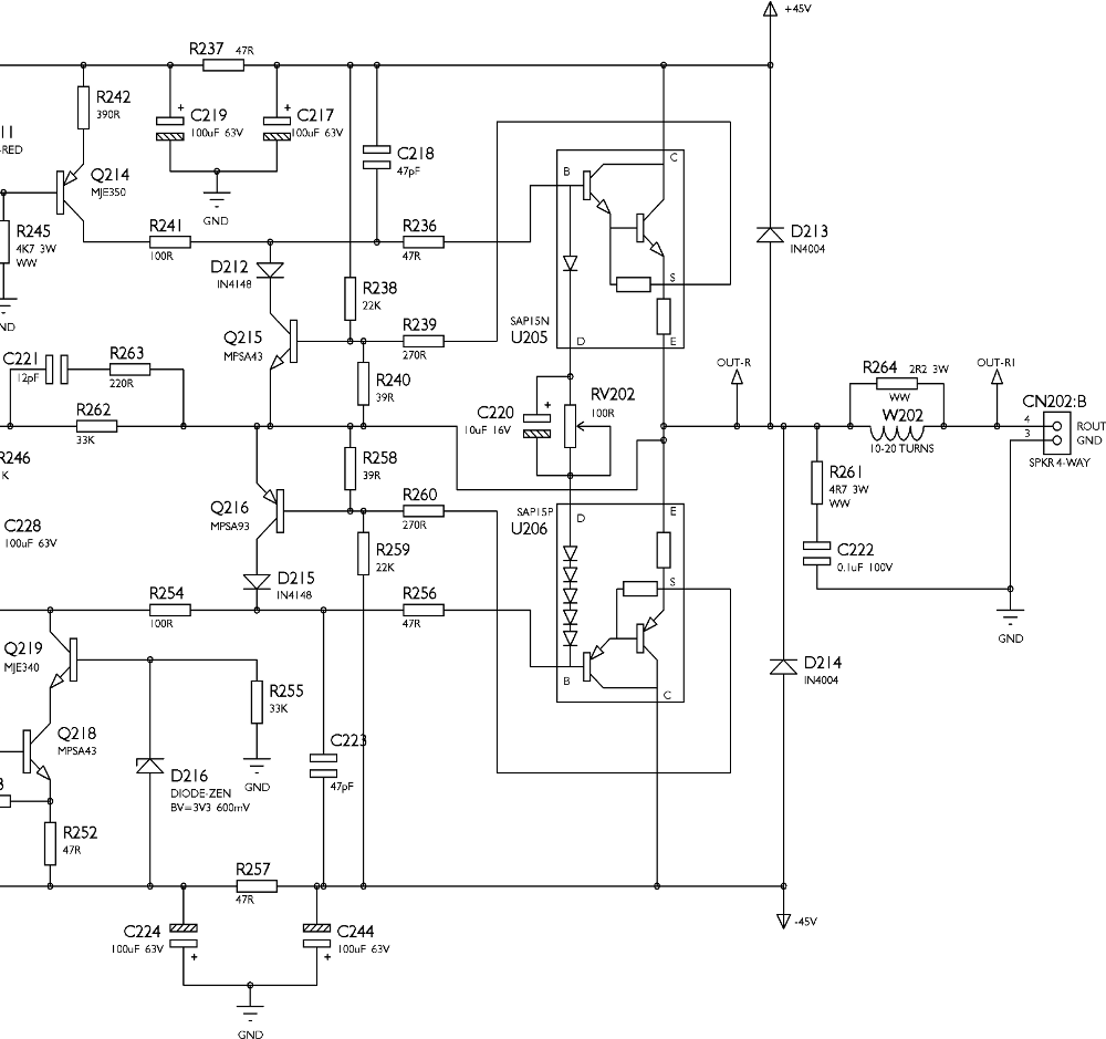

Each channel will have a trimpot on it, a variable resistor if you like, to adjust the bias. On the schematic, these are RV201 for the left channel, and RV202 for the right.
Using a voltmeter that measures millivolts, connect clips to the S and E pins of the SAP16N (this is the two pins on the right as you look at the transistor from the front, with the screw at the top). Make sure these clips do not short - it might be better to tack solder some wire in place if you do not have suitable clips. The best kind of clips for this are these:
Switch on the amp with no speakers or sources connected. Adjust the trimpot for that channel until you get 13mV. Do this carefully in small increments - don't rush the job as you can blow the transistors if you increase it too much. The bias will "drift" as the amp warms up, so adjust it to 13mV cold and then let the amp warm up for about half an hour or so. You could also gently heat the heatsink with a hair dryer if you're impatient but I wouldn't recommend it. Re-adjust to 13mV as the amp warms up.
If you are replacing blown transistors, check that the trimpot and the capacitor across it are intact with an ohm meter before you power on. Sometimes the pot can go open which will blow the transistors pretty much instantaneously.

Measure the trimpot with an ohm meter. If it still reads 100 ohms it's ok. The service manual for the A5/A500 (same power amp circuit) is around on here. RV201/202 are the trimpots in question.
The capacitors are marked as C220/C238. If they look like they've exploded, replace them.
I say it again with these amps - these are NO GOOD for parties or extended cranked volume. The heatsink is simply too flimsy and the SAP's overheat and die. An L angle with some folded sheet is an incredibly poor substitute for a proper solid aluminium extruded heatsink.
