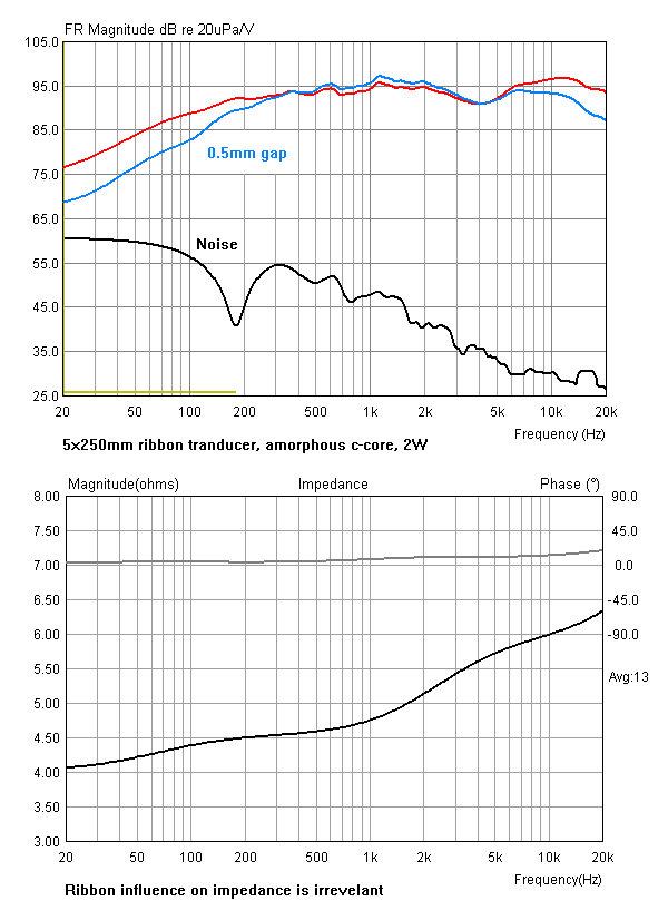

A few problems to the naked eye...

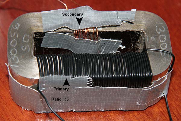

Not enough turns by a factor of maybe 100 or more?
A true ribbon is a lower Z than the amplifier, so needs fewer turns on the ribbon size, fatter wire and the proper ratio at that.
Measure the impedance WRT frequency looking into the transformer with the ribbon hooked on the other end. Is that the upper graph?
The phase shift shown looks not good also.

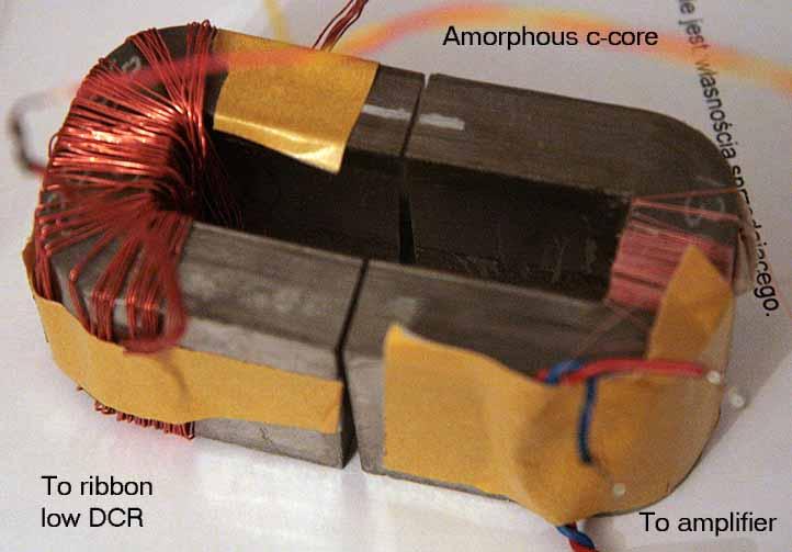

You need coupling between the two windings.
It's unclear that you have coupling between your two core sections.
The usual method of winding on C cores is to place the bobbin on one or both of the legs.
The gap is adjusted with a spacer, IF used.
Why are you concerned about too large an inductance?
The worst case for that is that ur LF response is lower than you might expect - but you need turns.
You need turns to handle V/A...
The efficiency may not be off if the ribbon is not getting sufficient flux across it...

Usually secondary is 6-10 turns and primary is 60 turns. If measured impedance is 4Ohms (bottom graph) than I don't need more turns isn't it?
Top graph is SPL plot.
Can you write more?
Usually the biggest problem is to find a good wire. At the moment I'm using some from coils found in TVs.
Should we use Farraday shields between windings? As I understand it is a thin foil with metal layer.
Low efficiency indicates that ribbon contats plus wire has impedance maybe too large compared to the transformer secondary.

Amount of turns required cannot be calcululated from impedance only. The lower the frequency , the more turns you need to get the same power on the same core. This is because core material is saturated at lower frequencies. The larger core is , the harder it saturates. It is impossible to say if 60 turns is enought without knowing what is the input voltage , lowest operating frequency, and core properties.
Imput vs output volatage is directly proportional to primary/secondary number of turns ratio( N1/N2 = V1/V2).
For example , if you have 60 turns primary and 6 turns secondary the ouput voltage will be 10 times less.
The reason for low effieciency may be to thin wire(much energy is lost in copper) , incorrect turns ratio or something else. Enamel wire should not be wound directly on core since sharp edges can damage insulation.
There is a transformer calculator online at :
http://www.bcae1.com/trnsfrmr.htm
Audio transformers are not so easy to make and I suggest you carefully reading basic operation principles before rushing to make something that works.

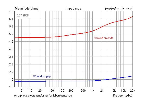

Now wire is over the gap for both secondary and primary. I've changed primary wire from very thin to standard signal wire, 1mm diameter. Impedance dropped with DC resistance. This part I don't understand. I look for higher impedance like 4 or 8 Ohms. Does it mean I need a lot of copper? Comparison with last wound appended.

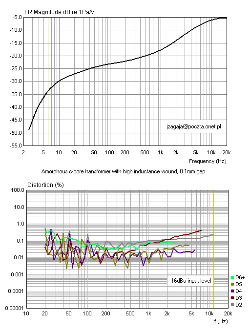

Transformer can be designed with inductance related to one leg of a 4th order xo or to have built-in high frequency shelving for an acoustic lenses. When I replaced magnetic wire with AC mains cable (larger diameter) then I saw a big rising impedance curve. Measured SPL (MLS) and distortion (stepped sine, 1/6oct) appended. Have no idea why such a large inductance, maybe thick cable insulation?
It is Arta Software, cheapest, popular application but very powerful. With balanced soundcard like Digigram VX it's perfect for a home constructor.
