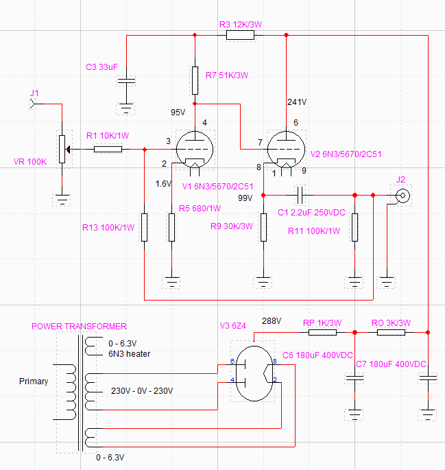

The attached schematic shows to use a 2x230V transformer, with a 0V middle point, to be connected to the ground (not shown on the schematic, but on the PCB).
When I switch it on, the transformer makes some noise, and the resistance RP (1k ohms, 3W) heats up to smoke, and of course I don't have the announced values of voltage.
I wonder what's wrong: the 6Z4 tube says performing up to 2 x 350 volts. See the attached PDF file.

The kit says some 5670 tubes could be usec (same pin connection), but actually I installed the 6N3 - anyway, it smokes even without those tubes placed in the socket.
Attached the schematic, if the auction would end.

To all who replied: C6, which has been taken from my box with hundreds of caps, had it's printing almost gone, and I switched plus and minus... shame on me!
Now it's working, at least all the voltages are OK, no smoke and nothing blown away.

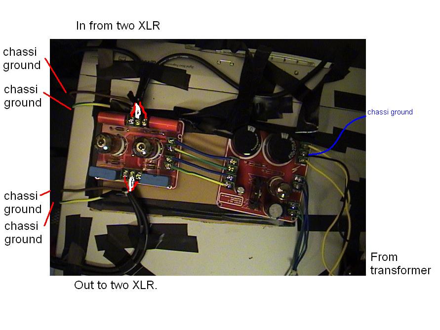

Now the only problem is that one of the blue tubes in the middle position is blinking, perhaps indicating something is a bit off.
Study my wiring in my photo and make a guess.

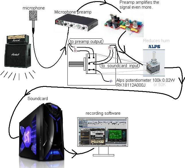

This is what I had to do to make it into a micrphone preamp. First I use my rather weak but clean Studio Projects VTB-1 preamp to the microphone or guitar. That gives me a balanced XLR out and a unbalanced TS 1/4" signal. It has a tube, but just as an insert effect tube which is rubbish compared to the real thing.
My DIY tube preamp is unbalanced (as I most recently were told). To use not only the Gain control and High Pass Filter, but also the volume knob and meter on my studio projects preamp, I will have to connect the tip and ring together in a Neutrik TRS 1/4" connector. This is a special function for Studio Projects I guess.
My analog inputs on my Lynx L22,which has a softwar controlled +4dB and -10dB, are XLR. So I have to make an XLR unbalanced. Inside the XLR male which is going into my soundcard from the preamp I move the white cable to the red cable and link the place where the white cable were - to the ground.
On the three preamp audio inputs, ground is in the middle, right channel has both red and white, and Left the same from the other cable.
Done!
Finally got it. Here's a Guide for n00bs.
I could not wait for an answer and tested the 100k 0.02W Alps stereo potentiometer ($15 in Norway) on the DIY tube amp output and as you said the hum disappeared. This is a really cool preamp. Before my sound was dull and uninspired and weak. It did not work to amplify it with software. Guitar Rig worked, but then it is not your signal any more, just a modelled sound. This preamp amplifies it so I can almost use it out of the box (though the preamp came in a letter). It even kicked some life into my ultracheap Alto mictube.
I am still worried than I should not use a hifi preamp desigend for amplifying signals to power amplifiers, and perhaps not the way I use it - as a mic amp, amping the signal from my weaker mic amp, see picture. I am afraid to burn my soundcard again if the signals does not match.
It preamplifies an unbalanced signal and the soundcard has a -10dB. It should be OK, but it amplifies with 30 W and that seems a lot. My 0.02W potentiometer har survived on the output so I guess those Watts are not in the audio signal. I know so little!

Recommended: $15 Alps 50k or 100k stereo potentiometer RK18 at the output for reduced hum. See picture for wiring guide.
