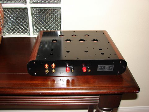

I am building my first amp with a pair of 7591 in PP and have hit a slowdown figuring out the preceding splitter stage. My initial thought was to use a 12ax7 amp stage followed by a 12au7 splitter. I am planning to use a -20 bias on the 7591 so I am looking at a max 40v pp to drive each 7591 tube.
The 12ax7 has to much gain. I am assuming an input of 2vpp on the 12ax7.
If I use two 12au7 then there is not enough gain.
Should I lower the gain stage of the 12ax7 with a lot of negative feedback from the secondary of the transformer? I don't know if there is a good sounding tube to replace the 12ax7 but with less gain.
I'd appreciate any suggestion. I already built the chassis and would have 2x 9 pin sockets for the splitter circuits, it will be a stereo amp. I have built the chassis myself, see attached picture. I think it will at least look good... There are a total of three 9 pin sockets, one of them is for an amplifier section before a tone control circuit. The output of the tone control circuit will have aprox 2Vpp.
Alfredo

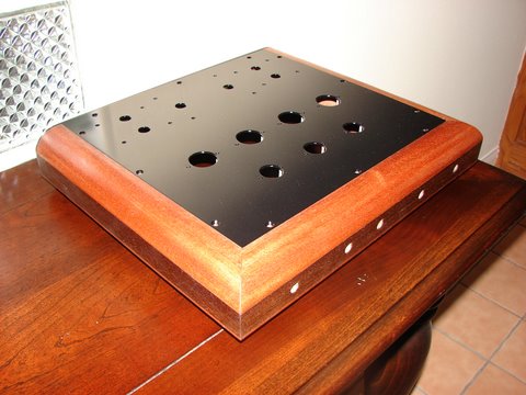

were do you get a 6n6p? Is it a good sounding tube?
BTW I attached a back view of the chassis.
Alfredo
