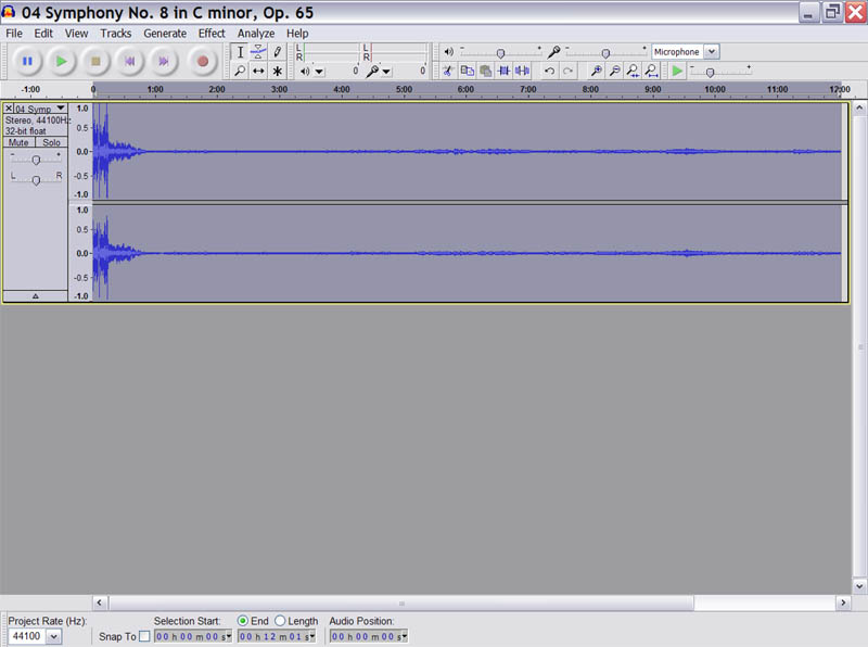

At risk of asking a heretical question...has anyone else experimented with dynamic compression for ripped (AAC, MP3, etc.) tracks? I've been trying recently to produce separate versions of my small collection of symphonic music for more casual listening in the kitchen. The problem with the originals is the large dynamic range for much of this music makes it difficult to use as background music. Quiet passages are lost when the volume is adjusted to keep the loudest passages from overwhelming conversation (or scaring the wee kiddies). I've grown accustomed to listening to public radio broadcasts of classical music, but lately have found the selections rather off-putting (ie. lots of John Williams and other hollywood soundtracks). The music is being played through a Tivoli PAL radio, so high fidelity in the source is large wasted.
I've tried importing tracks to Audacity and compressing at -12bd and -18db using a 2:1 or 2.5:1 ratio. I'm exporting the processed file as a VBR MP3 (200-250 kbps). Depending on the content of the track, the results have been promising, but I'm curious if anyone else has done this and might offer some tips.

graphical example
Here's an example of a track that is rather difficult to manage...
Shostakovich Symphony No. 8 in C minor OP 64 - Largo
