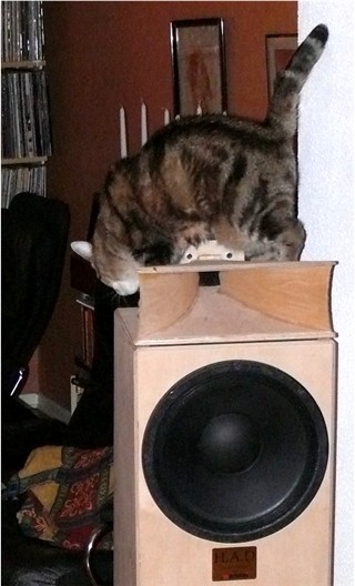

The B&C drivers are good, i have used the DE900 a lot at home matet with 12" drivers Eminence Kappa pro12, good, Beyma 12LX60, imo among the best 12" you´ll find. Have changed hf to Beyma CP380M wich i find even better, also cheaper. Dont forget the Eminence PSD2002 driver, real value for money! You have to xo it at 1500 or higher thou.
Here's a good project with 12" fullranger + supertweeter of your choice (Personally I think I would go with the Eminence APT-80)
http://www.fortunecity.com/rivendell/xentar/1179/projects/afterburner/Afterburner.html
Instead of plastic hornflares it is quite fun and not very hard to build your own exponential wood horn. You don´t need many layers of veneer to get a structure that is "dead" inside the used range, best, of course, ist to go CSH, cat supervised horn, the slightest squeal or squeek is promptly dealt with.
