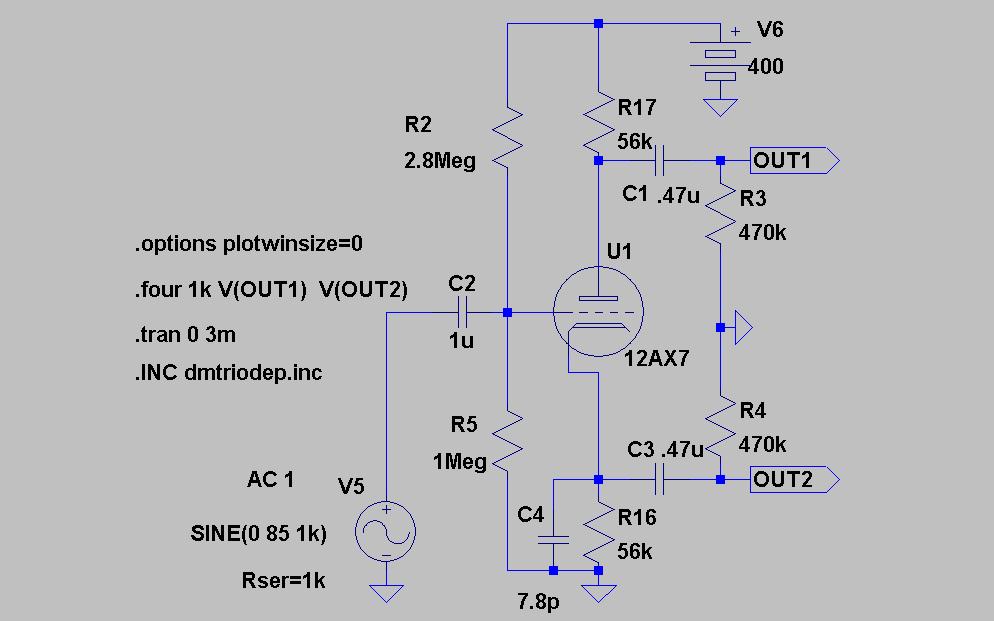

One of the differences must be that the tube has unequal capacitances on both sides. This can be equalized with a small cap between cathode and ground. The schematic is a simmed version of the PaulC mod of a Princeton PI to which I have added C4 to get identical Fu:

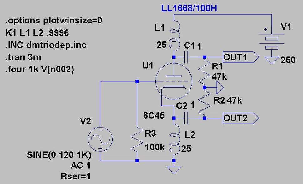

I just did a Spice simulation of a 6SN7 with 15k anode and cathode resistors, it has an output impedance of ~330ohm.
This is described together with the cure already in Valley and Wallman Vacuum tube amplifiers, the say:
Cgk/(Cgk + Cko) should be equal to Gm*R/(1+Gm*R) where Cko is the cathode to ground capacitance, they also say that in order to fulfill this you need to add more Grid-Cathode capacitance.

Go back to your 6SN7-sim this and you will find it completely wrong in this case ;) ! Tried adding G-Ccap at first but cathode to ground is the only way to make compensation work.
:EDIT: I was wrong! Did a sim on your 6SN7-circuit(with 220k load) to verify and if you use a ca 10x higher G-Ccap(78.6p) than G-Groundcap (8.27p) you get about the same result.

This is a little OT but this one, that I will soon try IRL, has 50ohm Zout, -3dB below 0.1Hz and very little risk of being overdriven
Sorry Hans, Go back to your 6SN7-sim this and you will find it completely wrong in this case
Could be, I only quoted from Valley and Wallman from memory but I never have tried it myself, it is often not needed to add any compensation as the poles created by the phase splitter output impedance are so high up, e.g in my OTL the poles are at about 3MHz and has a minor impact on the overall frequency response.
When I read from Valley Wallman the exact text is Quote: "This requirements usually necessitates adding grid-cathode capacitance" end quote, meaning that is usually but not always the case.
