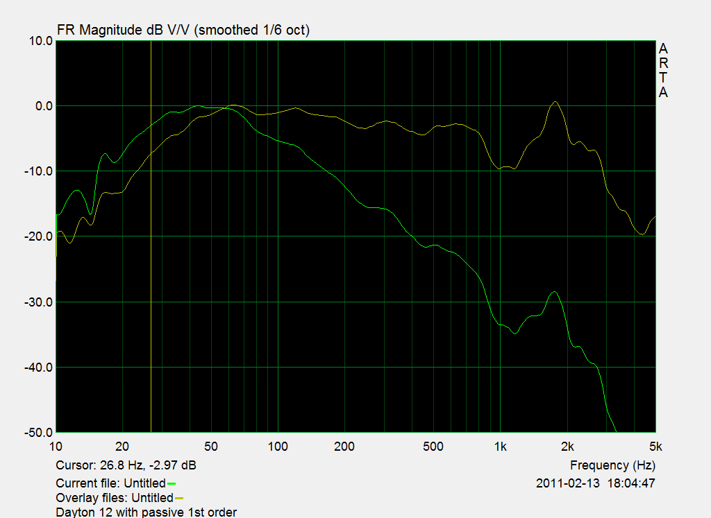

Finally took a nearfield FR measurement... and found I really need a new receiver. The LP crossover in my Pioneer VSX-517 just does not cut it. It's set to 100hz right now, but the -3db is around 130hz. The -12db is around 300hz... that is bad.
I need either an amplifier with a built in 24db/octave LP and a parametric equalizer, or a Behringer Feedback Destroyer Pro.
I suspect the dip peak at 280hz is an enclosure resonance. The box is not stuffed right now, so there is nothing to dampen the primary pipe resonance. My enclosure is 24in deep, which happens to be the half wavelength of 281hz.
Dan
Dan
I added a quarter pillow worth of stuffing in between the braces, hoping it would attenuate the 280hz dip/peak. Instead the stuffing eliminated it, amazing.
The stuffing helped, but I still was not happy with how much midrange was creeping through. -20db @ 400hz and -40db @ 900hz is not very good for a subwoofer. I added a passive line level 1st order LP filter between the receiver and sub amplifier, and achieved excellent results.
-20db moved down to 250hz, and -40db fell to under 600hz. The reduced output at the crossover frequency allowed me to turn up the volume on the sub amp a little, without making the midbass overpowering. The results are better integration with the mains and more low bass
Dan
Dan
evad said:Good to see you're making progress. Could you show me your LP filter design?
The filter is very simple, just a 10K ohm resistor in series and .88ufd capacitor in parallel with the input on the amplifier.
Thawach - I did not use a coil, only an resistor and capacitor. This is after the 2nd order digital crossover in my receiver, so the total rollof is about 18db/octave.
Dan

I've attached my measured response curves. The first attachment shows nearfield unfiltered response (yellow) and nearfield filtered response with a passive line level filter (green). The filter is a simple RC filter, with a 10k resistor in series and 1uf cap in parallel with the input on my amplifier. The amp has an input impedance of 15k, and I believe the crossover frequency is about 16hz. Yeah, that is low, but it's first order and my receiver has no problem driving it. The main benefit is dropping the f3 from 40hz to 27hz, yum.

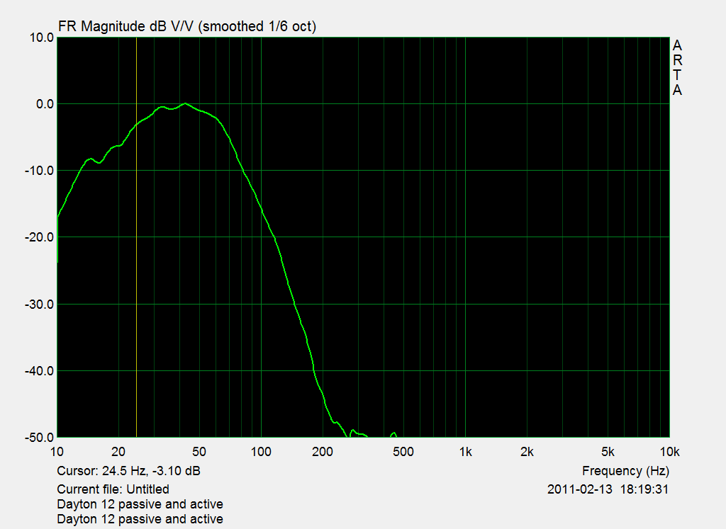

The second attachment shows nearfield response with the lowpass filter of my receiver set to 80hz. Looks like my receiver has a 24db/octave subwoofer crossover. Combined with my passive filter it makes for a 30db/octave slope, this thing just disappears.
