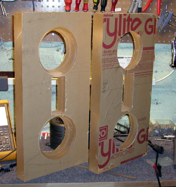

I didn't check it myself, but acrylic probably has better damping properties and sounds better than Lexan. You can even feel the difference when handling both. Here's my recent baffles, machined out of 2" acrylic.

Wow, great baffles! :)
I am looking at making a replacement platter for my Rega Planar-2 out of 1-inch acrylic from McMaster-Carr. The examples I have seen on the net are mostly done on a machinist lathe, but I was thinking of doing it on a router with a circle cutting jig (since I don't have a lathe).
The main issue I was worried about was chipout on the rim as well as the relief that I will have to machine out of the center.
How much of a concern should this be for me? Does anyone have recommendations about router speed and bits?

I didn't have problem with machining that piece using router. I used regular wood bits, the one for cutting was 1/4" straight cutter. The speed was less than maximum by 25% I guess, but the best is to try on a piece of scrap material. Since the baffle was 2.5" I cut everything in two runs, it is better that way (if you unsure 3 mighty be even better. If you want to make it nicer afterwards you might use a template with a straight bit with bearing guide, but best finish is done by sanding and buffing.
