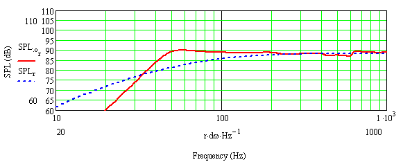

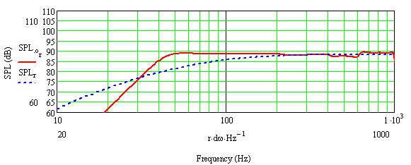

You don't specifiy which MLTLs (or drivers) you've got currently, but by shortening the vent, you will raise both the tuning frequency & also reduce the damping of the cabinet as less resistance is placed on the internal standing waves.
So, the cabinet with the shorter vent will indeed sound louder in the LF at least (though it won't go as low), probably exhibit a little more ripple higher up as there is less attenuation of pipe harmonic modes, and perhaps a little less compression of the LF, though those last will be very subjective.
For example, here's GM's MLTL31 cabinet (IIRC he advises a 2in x 5in vent for a max-flat response & adjust to taste from there for that particular box) with a 2in x 4in vent:
