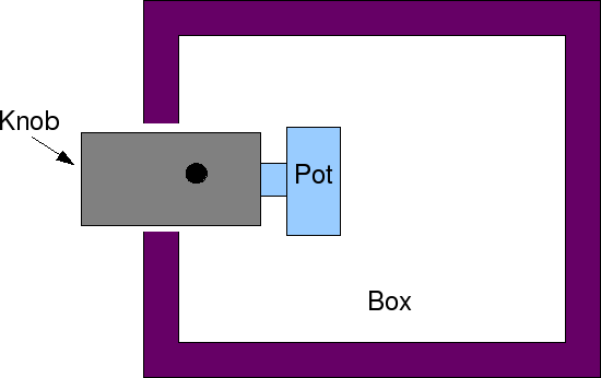

One alternative: I "could" make the hole in the panel larger, so that the knob could slide partially "into" the panel (and farther onto the shaft). But I want to try to avoid that method, if at all possible.

A couple thoughts- there are/were collet type knobs where you put it on the shaft, then tightened a screw in the center front. This drew up a split collet (like on a lathe) to grip the shaft. A center cap then snapped over the front. No idea where to get them, but a search might turn them up. Maybe start with Rogan. You could also get hold of the guy who posted here recently about his new metal lathe he bought for making knobs. Perhaps he could be persuaded to make you a custom, with the setscrew in just the right place to hit the short shaft. The idea of making a sleeve to lengthen the knob and bring the diameter to 1/4" for standard US knobs is appealing. If it were a good fit and installed with something like Loctite 271 or stud lock, I'd expect it to be reasonably permanent.

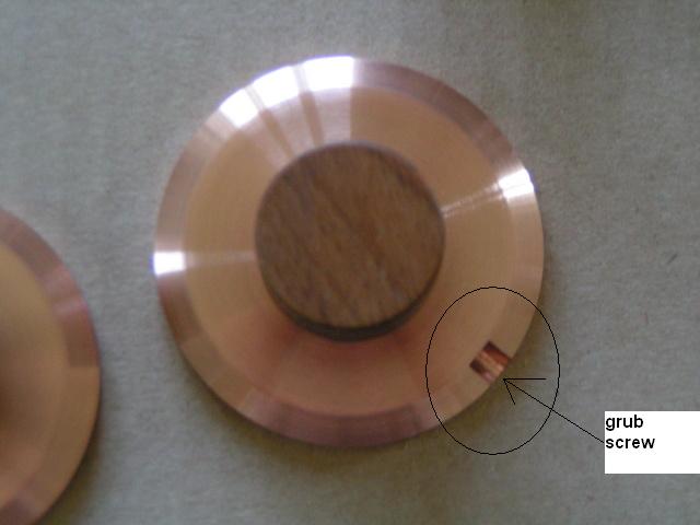

Magura said:
If you take a closer look at the BAF-07 knobs, I think you should be able to see the solution.
http://www.briangt.com/gallery/album64
Magura :)
I guess "should" was the operative word, there. :) I can't see the solution.
It's causing me pain.
So would you please explain,
to my sleep-deprived brain,
a little more-fully, what's germane?
- Tom
mpmarino said:
As ugly as they are:))), they would probably do the job.
Tom, if your not in a hurry, maybe I can help.
- Tom
I think the two of you should have a little chat, that just might solve your problem.
Tom,
If you take a closer look at the buttons in the pic, you will see that the set screw has been moved all the way back and there is no recess in the back of the button.
This allows you to mount it on a shaft down to approx. 3mm lenght.
Magura :)
The grub screw is as far back as physically possible.
he he... what he said.,
