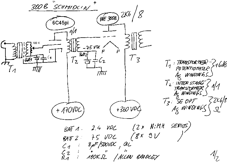

>100% support Hihipos. I actually built mono blocks with the attached schematic using IT LL1660 and an WE input transformer 20k:80 of -19db. Warm and sweet, extended bandwith, clarity, no roll-off and, last of all, natural. I totally satisfied with 6C45Pi from Russian mil. but shall search for WE 347/317 for a comparison. This is very simple to build, no hum or noise. If anyone need tips or more info, just give me a note.

Would be another joke. You can heat the tube with solar power.
Anyway, for simplicity, just wire the 5v AC with center tap grounded. A little hum but will give lively sound. For a tighter control, let's do a regulated DC with a 100-Ohm hum pot and get the pot's center grounded. Enjoy your tricks.
