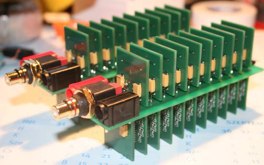

Meantime some significant improvements were performed:
The amp has got a new fully symetrical input stage (w OPA1632) and the output resistors were decreased from 10R to 2R. So the total outout resistance is already only 0.1 Ohm.
  • tpa6120amp.zip
