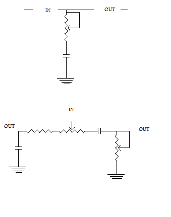

If you want a Tone control as most stereos etc have, then what you really want is a lowpass filter... ie a Treble control that only does cut, no boost.
http://en.wikipedia.org/wiki/Low-pass_filter
I found this on Google, it uses an opamp but sounds like it's exactly what you want:
http://members.tripod.com/roymal/ReverbTone.htm

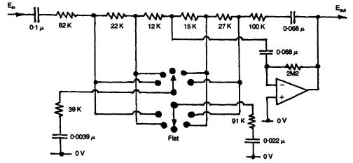

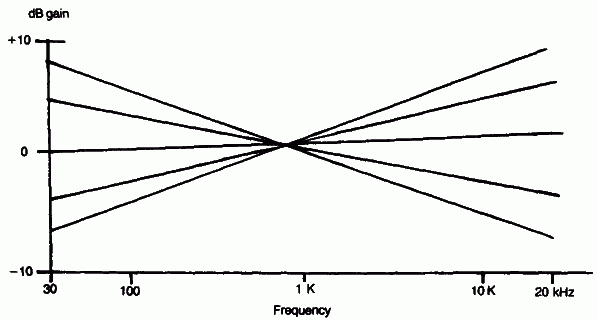

Here is a one-knob tone control. It boosts bass and cuts treble, or cuts bass and boosts treble; all with one knob.
http://headwize.com/images/eq_tilt.gif

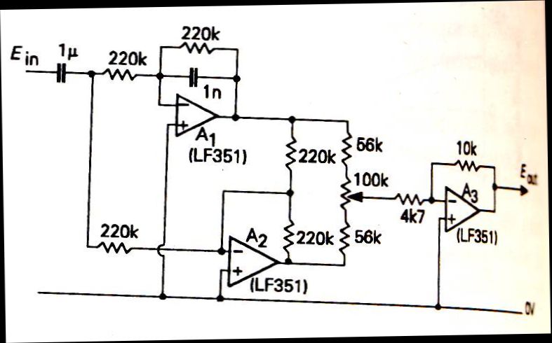

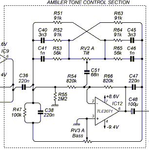

prorms said:would you have a schematic for Quad tilt control that use 3 ics
thxs
