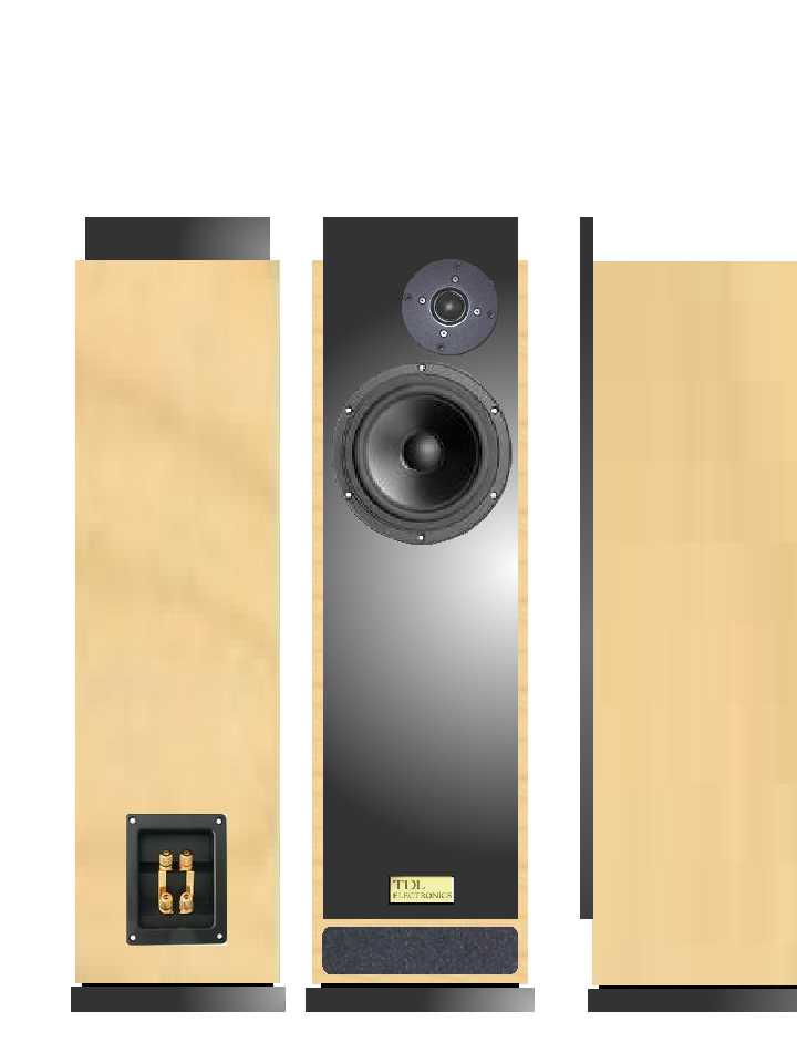

Heres a picture of the planned changes.
Existing cabinet is clad in 4mm Birch Ply exept front baffle which is cut out with a flush trim router bit. A new front baffle is made to accomodate the SS drivers in the layout suggested by Troels Gravesen:
(let me know what you think)

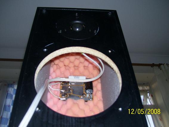

Upgraded Crossover and new damping material.
Hello!
I completed the first speaker today!
Fitted the 5.6uf Jantzen Cap and the new resistor. Added the Dimple foam. Added bitumin to the frame legs of the midbass.
Initial listening is very promising. On the track 'Take a breath' (from David Gilmours 'On an island' album) the Hi-Hat and Symbols were still clearly audible during the guitar solo, despite Gilmours screaming Stratocaster. During this solo the other instruments are much better defined where before they were drowned out almost completely! The clarity is much better, percussion and vocals sound more natural. Thers less of a 'shhhh' sound to the treble. And the added bonus is, the effect of better treble means the midrange and upper bass are better defined also. Theres a slight problem of the Bass sounding a little loose, probably because I left out some of the stuffing. I'll put more in and try it in different areas. Also I plan to fit some Dowling between the front and rear baffles to give the midbass something solid to screw into. Atogether the sound is warmer and smoother, without sounding wooly, for want of a better word.
Tomorrow after work I'll finnish the other speaker and give them a couple of days on repeat to burn in. Will post results.

Hello!
Pictures here: click.

Im going to draw up an image of the finnished article on the computer like I did above. I'll post it here soon.
