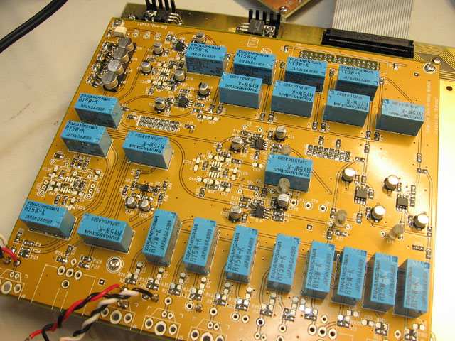

Just finished an Opamp based pre, with Shunt relay volume control, driven by discrete ADC.
Basically, it's just another IC preamplifier.

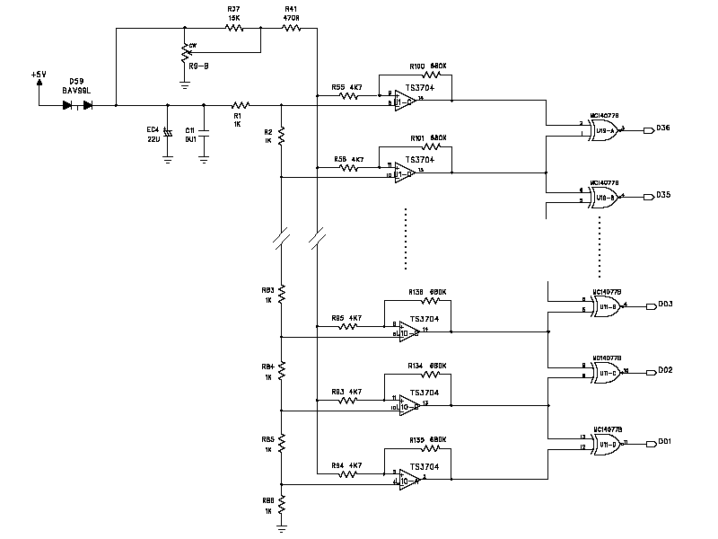

In my first prototype, I used ADC0804 to encode the DC voltage from Log volume pot.
VR pot -> ADC chip (parallel output) -> shunt relay
I thought 8-bit ADC can resolve the smallest pot movement, but I was wrong.
When turning the pot slowly, VR voltage enters imtermediate level between steps, and the Relays oscillate like crazy.

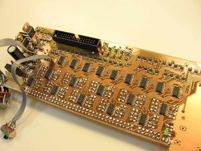

There is no way to add hysteresis to the ADC chip, so I have to build my own ADC instead.
VR pot -> ladder comparator (0111) -> XOR logic (0100) -> diode mapping -> shunt relay
It turn out to be a clumsy low tech configuration, with lots of diode and logic chip, but no MCU.

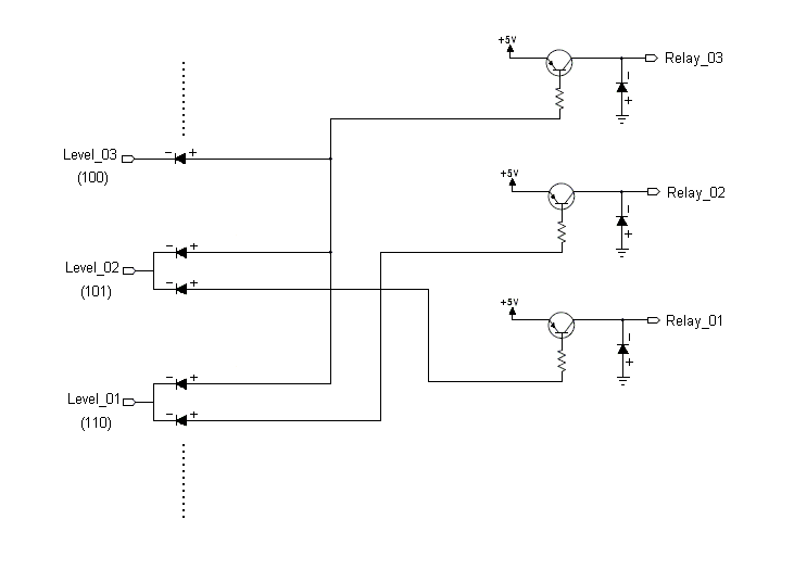

Great work! Is it for production or just your DIY project. On your initial ADC work, you might need to add a Gray code encoder so you have dictinct state while you rotate the VR setting, thus remove the oscillation between relays. Now I guess you are using "one-hot" state machine on your discrete approach. What is in your diode mapping scheme?
Can we do it in 8 relays to get 256 different states, like more than one of the 8 shut resistors engaged in parallel to get you lower volume? I would like to know more about your project and keep in touch.

There are 8 shunt relays and 256 levels, but only 40 control steps. The diode mapping is to route each logic output to the desire relays, step by step.
Yes, more attenuation can be achieved by adding shunt relay. Since I finished the audio main board layout before I discover the oscillation problem, I keep using eight.

I designed all PCBs and etched the discrete ADC board by myself. The audio main board (4-layer) and power supply board (double side) were made by sample house.

Some hysteresis trick with the ADC reference would have solved the problem.
Hi Gmphadte,
There is no access to the comparator front end inside the ADC chip, hysteresis can only be applied after the DC voltage is encoded. Some memory buffer plus MCU programming should do, but I've turned to the hardaway before figure out how...
When it is a hysteresis problem, invariably the VU led meter ICs come to my mind as a simple, easy-to-lay solution. However 50 steps will pose some problems. Moreover the encoding will need some more ICs.
So much to get some hysteresis...anyhow, it is another solution
