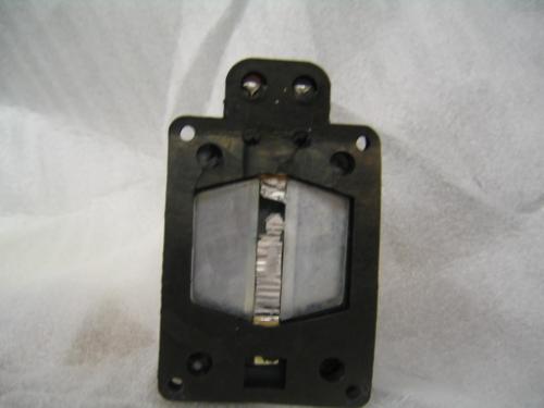

ribbon tweeter
picture of the Ribbon tweeter

i think u have the same model as i do
http://i14.tinypic.com/62yczo2.jpg
Mine are bulgarian tweeters made after goodmans specifications.
The foil is made out of plastic with a metal coating.
I don't know how u can build something like that.
You can try cutting a piece of aluminium foil and mount it between the two screws.
You will have to make sure that the impedance of the repaired tweeter has reasonable values.
Put a resistor (10ohm) in series with the tweeter, and connect them at a sinusoidal voltage source from 2kHz to 20kHz.
Check the voltage on the resistor and compare it with the voltage on the tweeter. The ratio between them is equal with the ratio of the resistor's and the tweeters impedance value. It should be greater than 0.3. Otherwise your amplifier will see a very low impedance and :hot:
good luck!
Hi Andy,
I specialize in ribbon microphones repairs, which have exactly the same principle, but use much finer ribbons (I am working with thicknesses down to 0.6 micron :eek:). I have the whole range of foil thicknesses, as well as a few corrugators with different pitches.
If you don't find any better solution I don't see any problem to repair those for you. I might be able to get a corrugated metallized mylar, as well.
