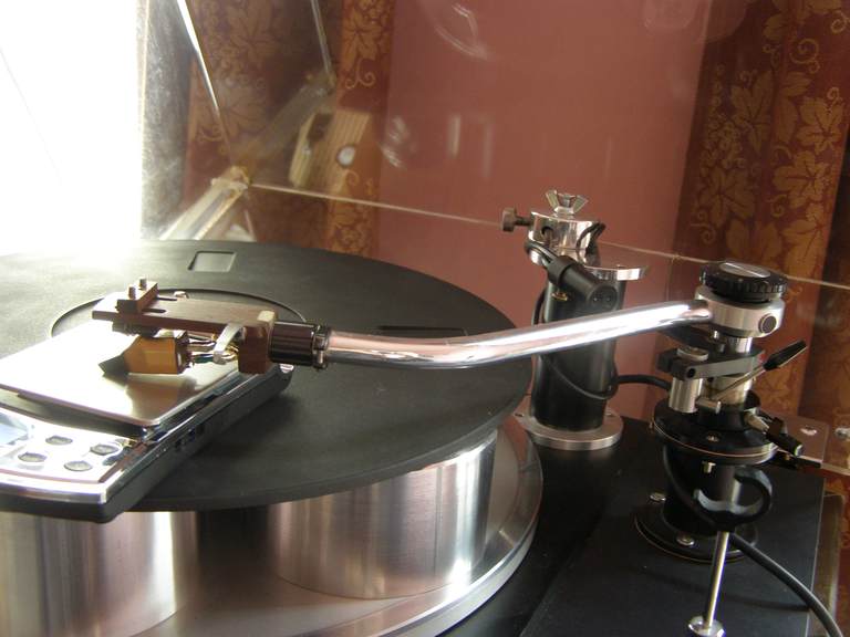

Effective mass mess
Effective tonearm mass ( E.M.) seems to be very uncertain and messy theme. It would be highly appreciated, if some serious professionals share some light here. There are many tonearms with unknown effective mass, as well as recommended cartridge compliance (not mentioned in manuals). Even in manual on classic SME3009 it is not there.
Question is: how to determine said E.M. of tonearm already owned? Or self-made?
I would guess, that E.M is equal to momentum of inertia. If we accept tonearm mass equal to its weight, than E.M should be equal to it's mass applied on stylus point. So, if we take off tonearm rear section with counterweight (pic. #2), and than measure gravity force applied on stylus point, using stylus force gauge (pic.#2), we should get E.M of tonearm (not counting E.M of rear section with counterweight)? Of course, E.M. together with cartridge, shell and mounting screws. Tonearm here is Micro MA101, and it's E.M. is unknown. Results are: arm+shell+ cart= 27,3g, shell+cart=20,9g, so
Am I on a right path?

My understanding is that effective mass is the integral of 'mass x distance from pivot', divided by 'distance from pivot to stylus'. It is mass rescaled according to distance, but unlike calculating downforce all mass counts as positive.
If you could remove everything beyond the pivot (i.e. the counterweight end), and assume that there is nothing above the pivot (i.e. everything either contributes to downforce or upforce) then measuring the downforce at the stylus would give you approximately half the effective mass. This is because the end you have chopped off must contribute roughly the same weight (but in the opposite direction) in order to get balance, but it adds to effective mass while subtracting from downforce.
Effective mass has everything to do with inertia and much less with real mass.
You can perfectly balance the stylus pressure with a counterweight that has half the mass and is positioned twice as far from the pivot point.
But inertia would be twice as high, because I=R^2*M, resulting in an effective mass that is almost twice as high.
Hans

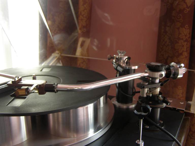

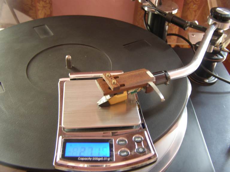

That is as I expected it to be. If I knew effective mass of my Micro arm, it would be easily possible to check this by experiment with gauge, and compare final result with already known numbers (it's rear section entirely comes off).My understanding is that effective mass is the integral of 'mass x distance from pivot', divided by 'distance from pivot to stylus'. It is mass rescaled according to distance, but unlike calculating downforce all mass counts as positive.
If that method works, it gives us pretty simple way to find E.M. of any arm, without disassemblying it, as well, as without using test record and complicated maths.Unfortunately, all three arms I possess do not have E.M. data nor in manuals, nor in datasheet. So, I'm not able to perform that experiment.
Thank you for detailed reply. Unfortunately, in many cases dividing it into sections would be too complicated, especially with arms of complicated shapes and sandwich like or composite structures.Calculating a tonearms effective mass is theoretically simple but can be difficult and laborious.

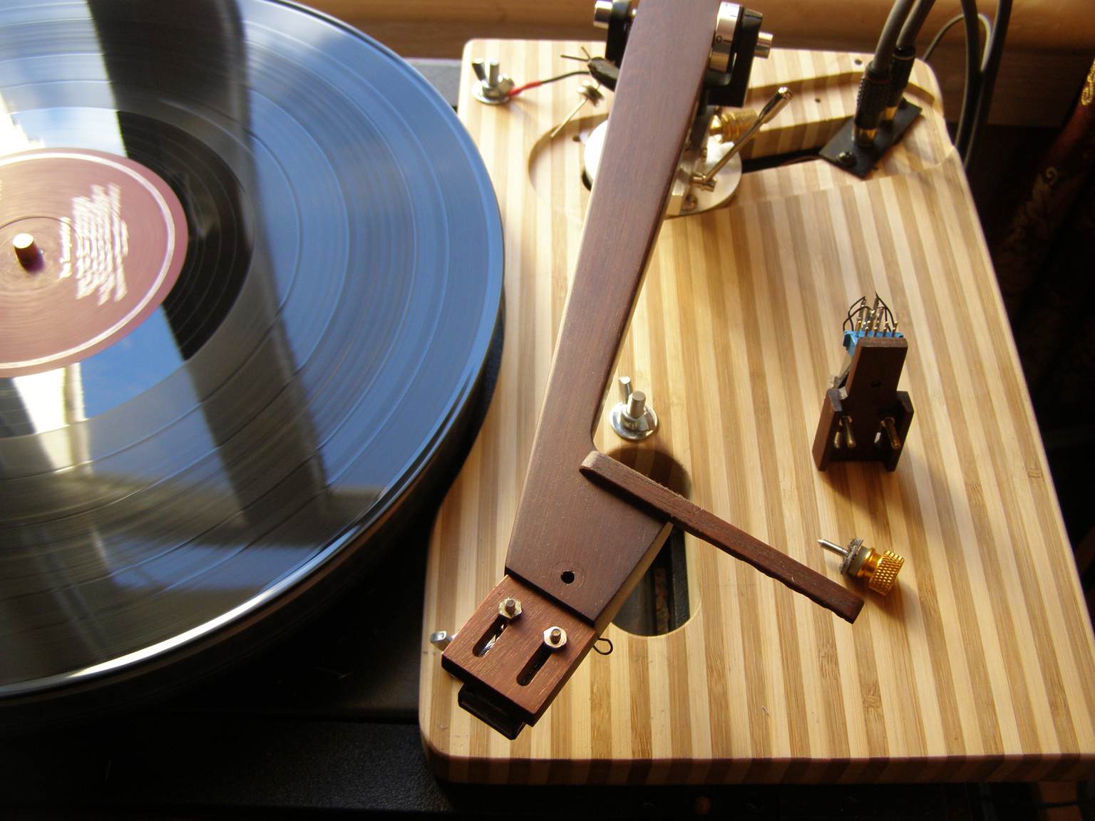

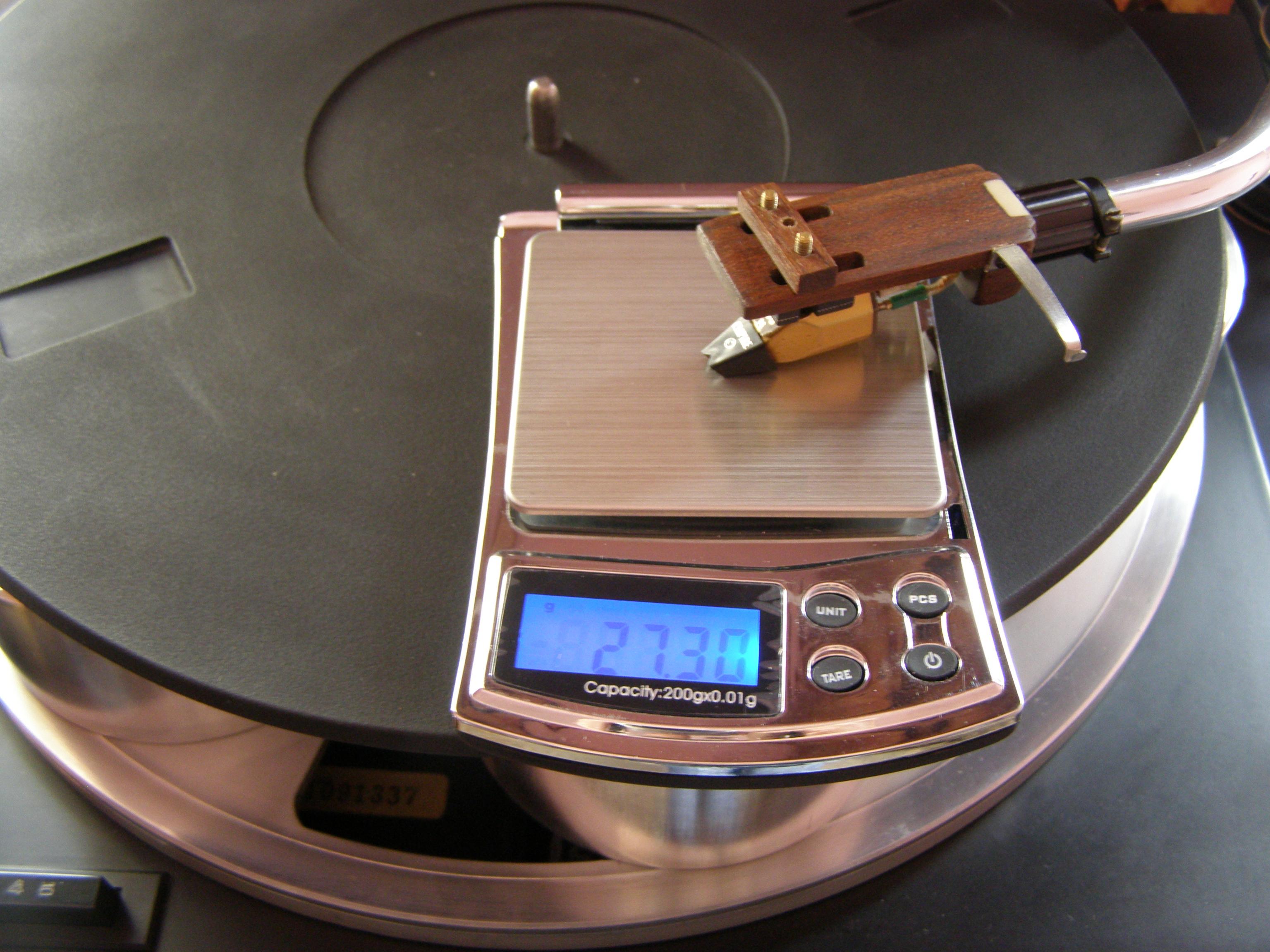

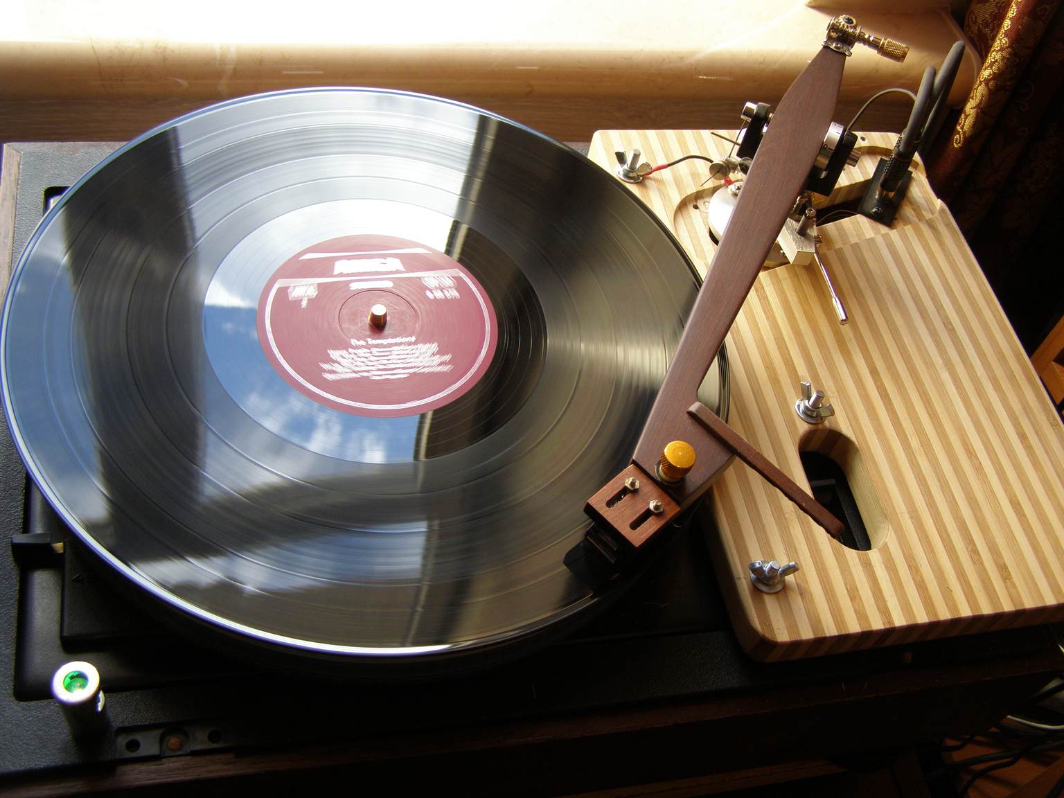

In my case, beside Micro MA101, I need to calculate E.M. for rather unusual arm with spring "counterweight".

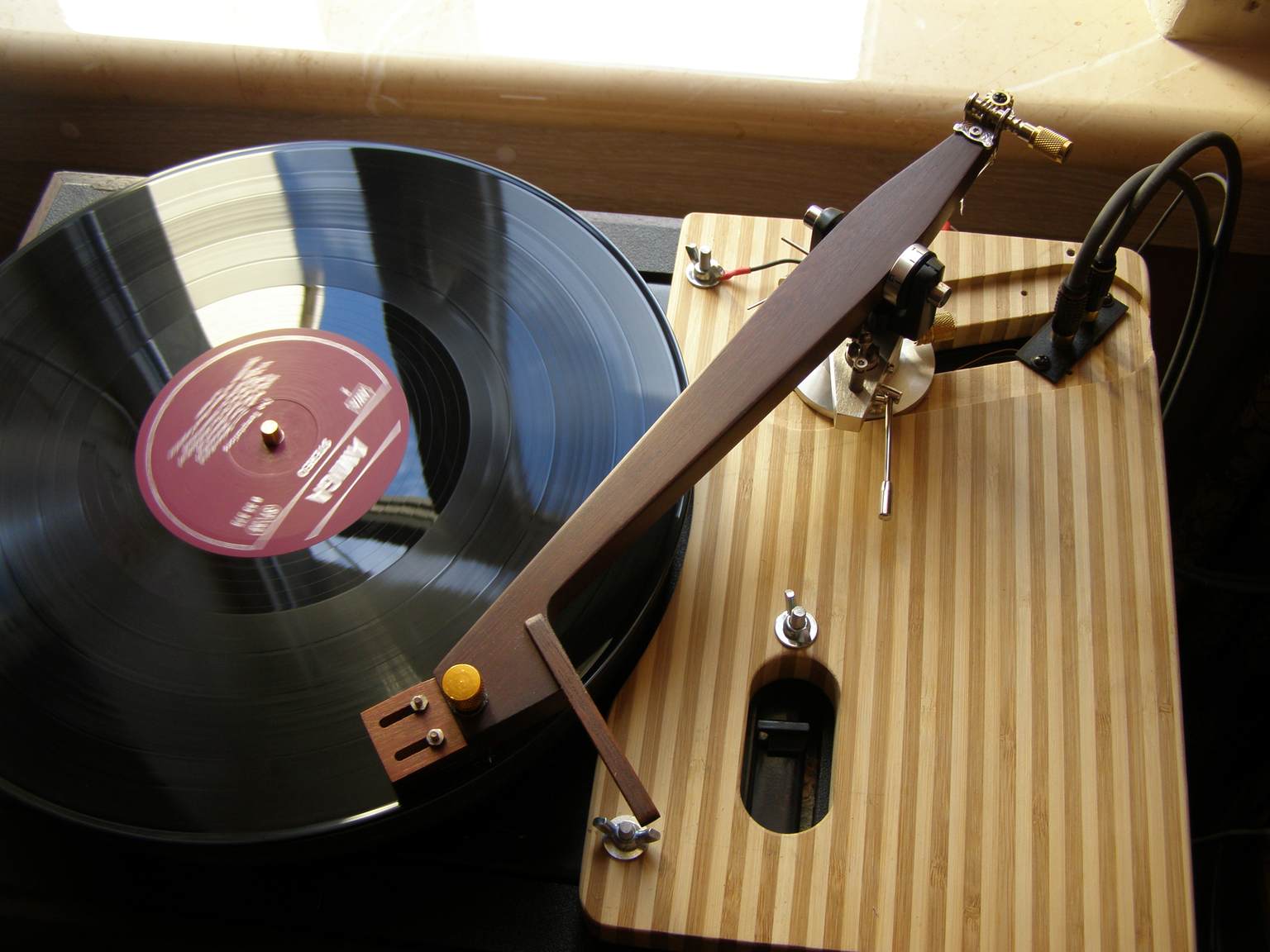

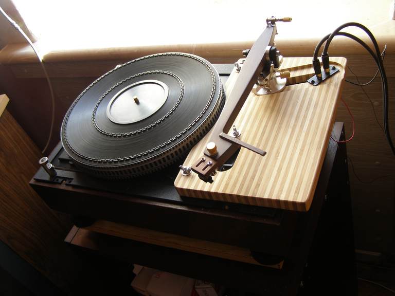

Hi walterwalter.
What a beautifully crafted arm, the finish quality is exemplary.
My arm is quite a complicated laminated design. I calculated the effective mass contribution for each laminated then summed them all. As I divided the arm into 1mm sections I did end up with hundreds of individual sections and a very accurate effective mass calculation. However this was part of a much larger spread sheet that calculated not only effective mass, cantilever resonance and tracking force but also resonant frequency of arm (vertically and laterally), tracking force variations due to warps and warp wow. This was all part of the design stage and was performed before any sawdust was made. As my arm is a linear tracker I only calculated vertical effective mass. I would hate to have to reverse engineer this for an existing arm. Also I have not investigated spring tracking force adjustment. I assume that the tracking force spring, having its own compliance, would have a separate effective mass/compliance resonance that would need to be at a similar frequency to the cantilever resonance. But as I said I haven't studied this type of arm so I may be missing something.
Unfortunately there are no shortcuts to calculating effective mass. The easiest way for an existing arm is to use a test record.
Niffy

Thank you Nyffy. Arm type, I'm experimenting with, behaves very differently from traditional ones, it resonates differently, it tracks differently, and becomes almost immune to outside vibrations and rumble ( amaizingly, rumble level drops 10 to 30 dB down, if counterweigh on the same arm is substituted with spring). The most inportant is the absence of gravitational counterweight. In my case it is spring loaded. Tracking force spring is not crucial, if counterweight still present.Hi walterwalter.
