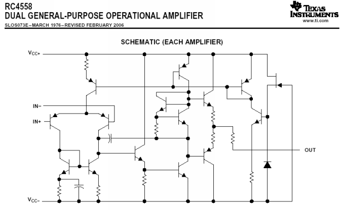

Hello
Yes I did read wrong it was JRC 4580 and it was a D suffix.
I have some NE5532 and OPA2134.
I have found the JRC 4580 datasheet, it seem a bipolar input.
Here the schematic of the JRC 4580
Gaetan
Hi Gaetan,
Pick up some OP275 at some point. Not a bad little IC. If you see any ceramic caps in that section, replace them with mica or polystyrene. That will do more for sound quality than you know.
-Chris
Try the OPA2134 then. Watch it doesn't oscillate. You need to check it muted, silent but playing and with signal. If it stays clean with all these three conditions you should be good.I have some NE5532 and OPA2134.
