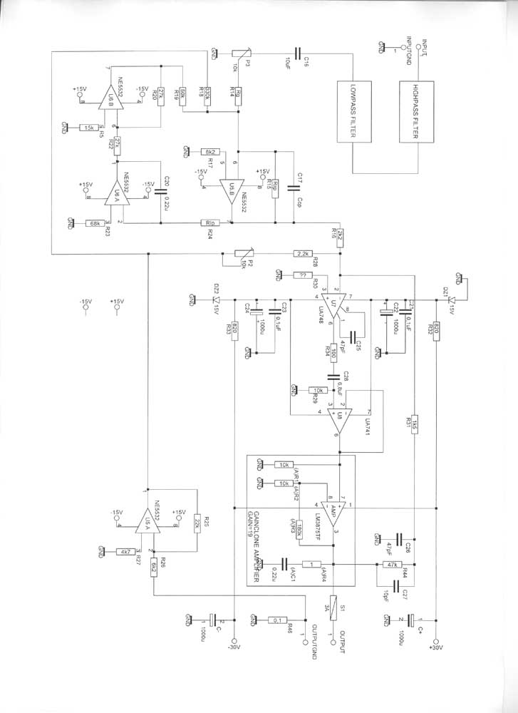

I am very much interested in the ACE-bass principle, invented by K.E. Stahl back in the seventies. I’ve found the patent of the principle and did a lot of searching on the internet. In this tread on DIYAUDIO I found a circuit of a prototype of Bjorno’s ACE-bass amp design.
I am planning to build such a thing to experiment with, and maybe when it give satisfying results build a sub for daily use.
Bjorno mentioned in one of his posts of the tread that the amp part can be replaced by an “gainclone” amp. This would be very practical since I’ve already built a Gainclone amp, which I can use for this project.
I have redrawn Bjorno’s circuit diagram with a Gainclone amp instead of the original amp. My question is: will this work, or am I forgetting some critical things here?
Bjorno, what does P4 (100k) do at the + input of uA748 do? Offset or something?
I am hoping that any of you can give me some feedback on this design.
Thanks,
Durxter

Bjorno, what does P4 (100k) do at the + input of uA748 do? Offset or something?...
durxter,
Thank you for re-writing my old schematic , it looks good as far as I can see. I’ve tested with a 3886 amp and it worked well.
Tip;You should insert a 10 K Ohm pot P (Rrs) in series with the Rrs resistor to trim the negative output resistance starting at max pot R value, then vary between this pot and pot P4, i.e. for every setting of P (Rrs) the output will drift and has to be counteracted with P4.
If you also have a PSpice program available then it’s very easy to model any driver in a closed box with a fixed Qtc and alter the virtual T/S parameters to target a new more suitable and preferred value of the Qtc at another chosen corner frequency.

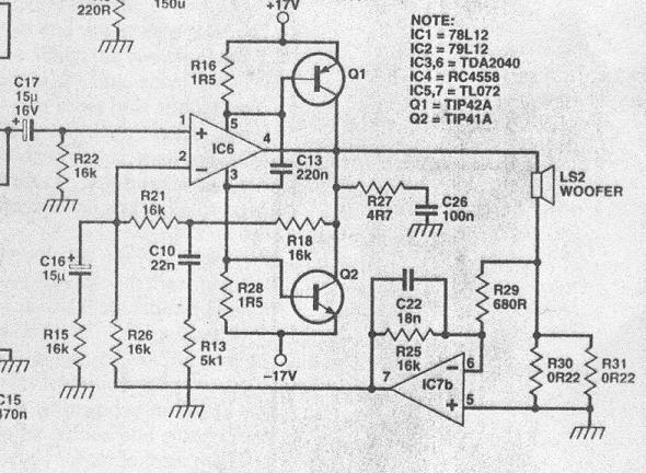

Here is my effort. It only does negative resistance Qe whereas the ACE
tweaks the Compliance (VAS) and the moving mass
Will give much better results than a sealed box with LT in terms of cone excursion, voice coil heating and depth of bass from a given size box.
R26 should goto the junction of C16 and r15 to avoid DC offset problems.

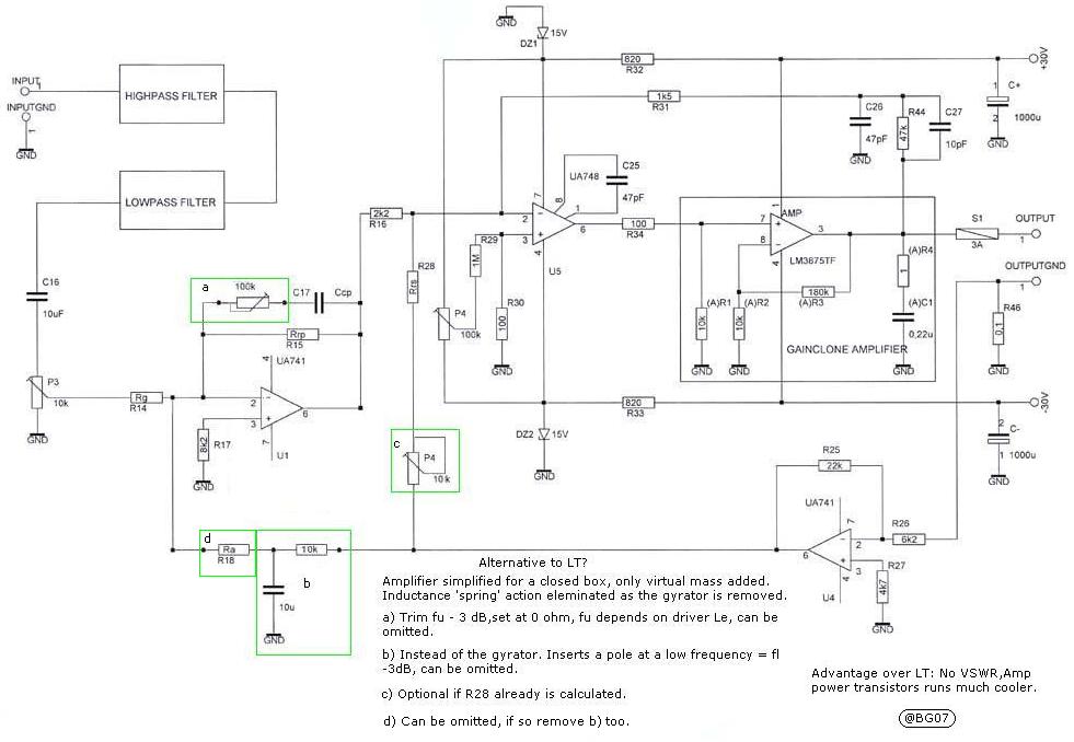

..But I don't understand how to determine the Amplification Constant (G) to get Rg.
The global gain G relies of the open loop gain through the band pass filter (closed through the gyrator feedback) x the closed loop of the power amplifier = Ao being much larger than G.
As G is 1/R14 x (R18xR26)/(R46xR25) you can think of Ao as an inverting amplifier (in reality positive gain) with the input series resistor = R14 and the feedback resistor =(R18xR26)/(R46xR25).
What is the advantage when using ACE-bass with a sealed box over a Linkwitz Transform Circuit?
I have never compared with LT and in a sealed box, I used my amplifier for small volume ported boxes (large ports) only and my favourite driver is the low inductance SS 21W85550.

Thank you Charles for this reminder, it would be very easy to incorporate this safety approach if a first order HP pole is placed at or below 2 Hz.
At time when I worked with the my amplifier I tested with 2 series 100 uF capacitors and 1N4148 diodes for the leak currents, connected bipolar at the inputs of R16 and R28 but later when I made circuit boards I eliminated these bulky capacitors with the offset pot.

The real advantage IMO is indeed only when this circuit is used with a ported box. The interaction between drivers and box is as if the drivers actually had the simulated parameters - something that wouldn't happen if the "un - ACEd" driver(s) were used with the same box and tuning. But it can't change the laws of physics and so the efficiciency remains low at low frequencies. But it is able to take advantage of the reflex loading, especially in terms of driver displacement.
I assume that it has about nil advantage over an LTF in a closed box.

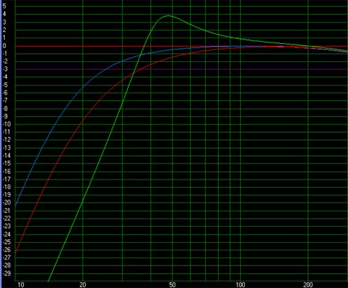

Strange things happening here. I've been doing some simulations with WinISD and a spreadsheet from www.diysubwoofers.org they both say that the design I made should be right....
In the response graph below you see:
- Blue line: Fs 16,8 Hz
Qts 0,33
Vb 47 ltr
Portlength 35 cm, dia 4,7 cm
- Red line: Fs 20Hz
Qts 0,33
Vb 38,7 ltr
Port length 30cm, dia 4,7cm
- Green line: Fs 16,8 Hz
Qts 0,33
Vb 47 ltr
Portlength 35 cm, dia 10 cm
The only reason I can think of is that you didn't choose the same portdiameter (4,7 cm) as I did. When taking 10 cm I get the same response as in your graph with -3db of around 35Hz and a large peak. What pipe dimensions and enclosure volume did you use for the simulation?
I think I will go for your suggestion (red line). It looks better than my suggestion. I thought that a lower tuning gives better group delay, am I right?

But most of the changed parameters can be simulated with for example WinISD, except for the effect of Le, right?. Very nice software though.
