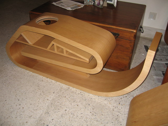

On a side note, I am also building a pair of BLH based on Ron's Dallas III for the Fostex 206. Its destined to be used in my bedroom with a 3 watt SET. Heres a picture of my progress on that front.

Cool looking.
I haven't made many back horn speakers, but found the more square the inside turns are, the more midrange gets filtered out, if your intention is just reinforcing the bass.
In tapered transmission lines, I found a 2 1/2 times as large cross sectional section just before the exit, seems to smooth it's output, sort of like a plumbing surge tank, I guess.
Cool looking.
Hi MITsound,
Just out of curiosity, with the T-line, do you place the driver at the beginning of the line? Or do you use the general advice of Martin J King, and place it 1/4 to 1/3 down the line to break up the strong resonances?
I know this question is a little OT, but I'm really interested in how you approach this..

About 38%, only because I try to incorporate phi into my builds.
Phi is good.
