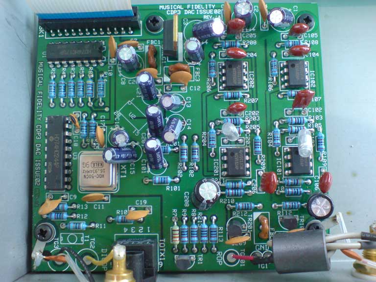

I've just bought a second hand MF A3cd player. I would like to hear from others who has made it even better. I have taken some pictures of the inside, so maybe I can get some suggestions.
The overall sound is very open, dynamic (exept for the deepest bass). I like the way it plays "Forwarded". Reminds me of Naim cd players. But I think it sounds a bit to "hard" and lacks some analogue character. The first thing that comes to my mind, when i saw the player inside, was the "Teapo" Caps. Anyone knows, and like to comment them?
Maybe they are the problem...maybe they sound a bit like SMH caps, wich I find very Hardsounding and "machinery like"
I have modded an old Denon cd player once, with some Elna Cerafine, and Silmic II caps. They did exactly what the player needed. But of course, not all of the places. Some original caps were left, since they sounded better than the Elna's in their particular places.
Any suggestions are welcome

Anyway i think that the first and chepaest option is to change the Op amps and also you can order free samples from analog devices as i did and ordered op275 but you will have to make some mail like brian@microsoft.com ;) because if you have brian@yahoo.com they are not going to send them because they say its for technical purposes and not that they give away for DIY because they want to make money from us :D so u will have to use some other domain for hte mail.
Next step by my opinion is to put capacitors on pin 4 and 8 0.1uF 50v like Black Gate NX on the op amps but depends you can search the datasheet from the op amps that you will replace if they ask it put it, on op275 i put and there is no oscilation...............
Other step is but i dont see on the pictures is to put shottkey diodes they are cheap like 50 cents one or 1 euro.
Also i can see that you have for op amps so probably this is because they are single so you can replace them with AD825 also order them free from www.analog.com

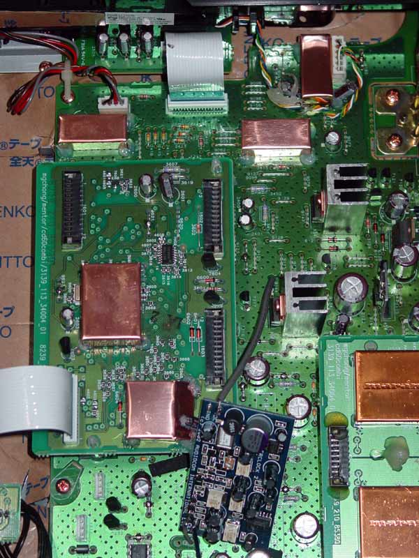

Other sipmple and cheap mod is to put copper plate around the torroidal transformer, and also on the Hitachi HD74HC244P, HD74HC175P whatever function this chips have shield them probably htey are Dac but shield them with cooper to isolate the RF. Also phillips 74hc244n and other that are inside. I will post a picture.......
Upgrade the capacitors for power supply with some Rubycon Black Gates FK or nicchicon. Like you have Teapo two 2200 35v and two 1000uf 35v. Also you can change all other caps to gain some better result fro example yesterday ive put 2x Black Gate FK 2200 35v for power supply one Black Gate NX 2200 6.3v and black gate STD 4700 16v and the overall bass get much more depper.

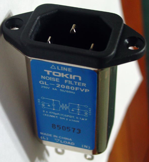

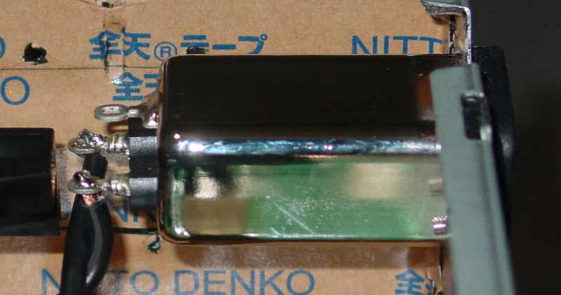

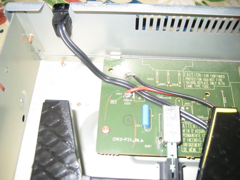

Hi ninety the cutout was probably for noise filter or for some cables but its strange because if you buy the player second hand why the guy take for example the noise filter out since that part is cheap:confused:
anyway post a picture.............
here is the noise filter
I also noticed that once I open the cd tray and I look into the cut out part underneath I see a piece from the transport that comes down , once the tray closes the piece goes back up , maybe this was pushing against the bottom casing so that is why the previous owner cut a square?

maybe it had some problems before as you say or maybe the design of the player its like that, anyway send mail to itzibitzi the guy that post this topic because he has the same player...........Also you can put some tape inside and outside of the chassics so dust will not enter into the unit afterall if it function nice dont care about the hole:D
Bye Alex
p.s from the picture i think the player its designed like that
