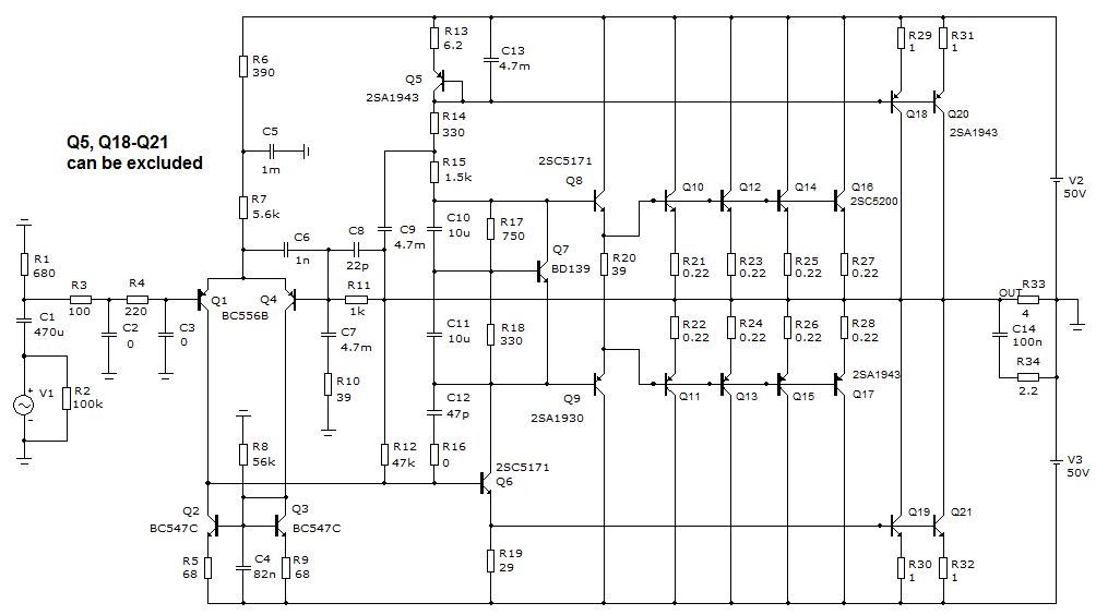

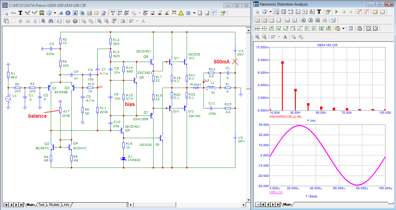

heating and power consumption can be reduced by removing the last 4 transistors.
если удалить 4 выходных транзистора, то теряет смысл оставлять 5-й который служит для температурной стабилизации последних. Если его не удалить ничего плохого не произойдет
if you remove 4 output transistors, it makes no sense to leave the 5th one, which serves for temperature stabilization of the latter. If you don't remove it, nothing bad will happen.

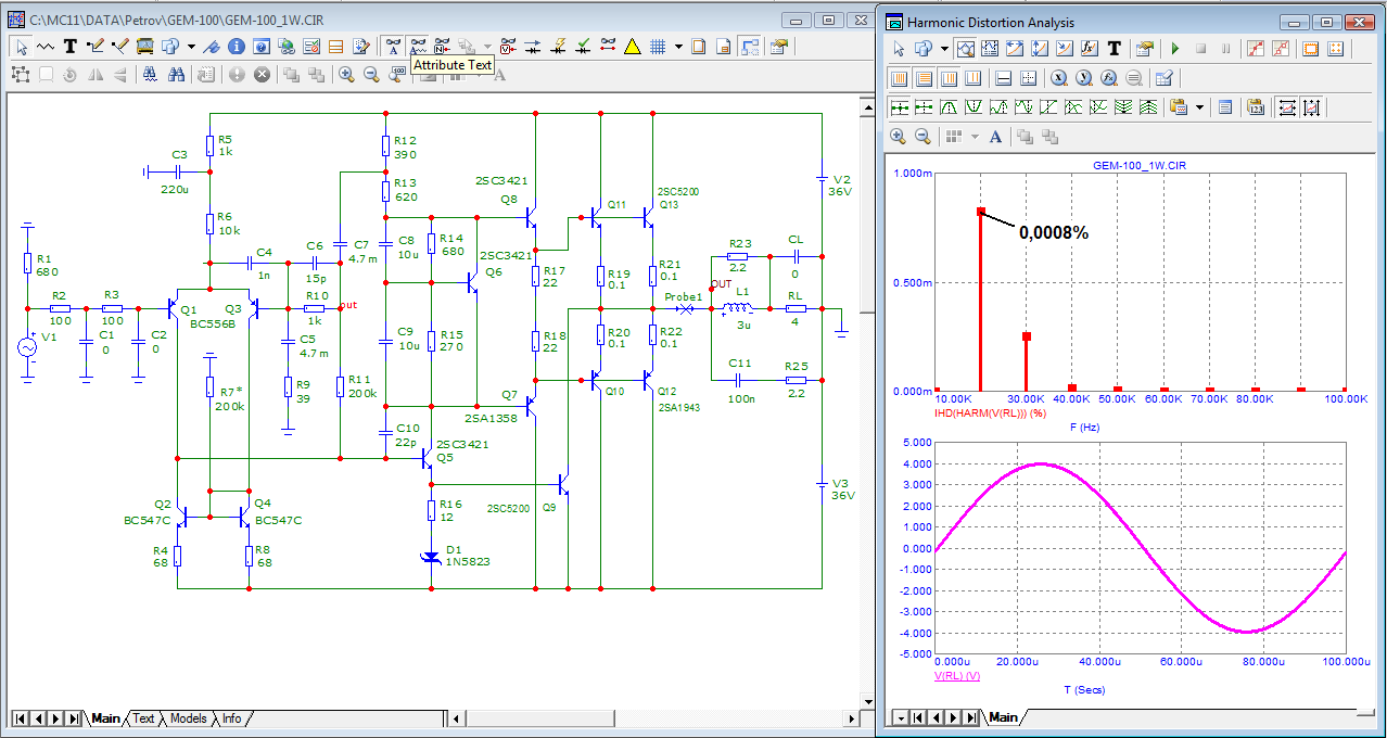

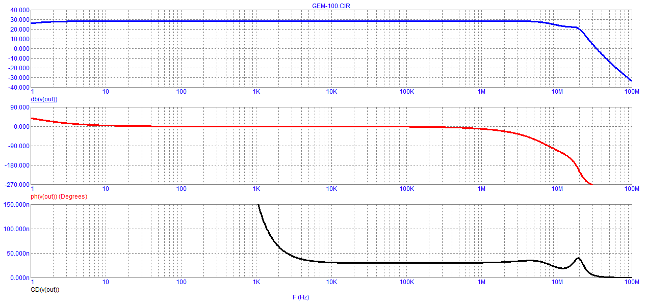

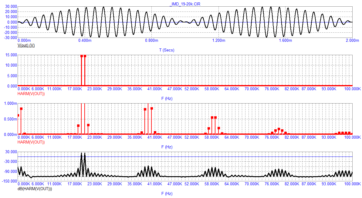

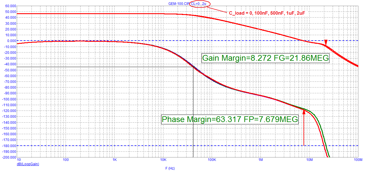

In memory of Graham
Graham really liked the sound of amplifiers with very low signal transit time (time Propagation Delay), in particular the sound of the JLH-69 class A amplifier.
Graham named his GEM amplifier after his father and used the LJH-69 amplifier circuit as a prototype.
Design goal: to make a more powerful and more economical amplifier while maintaining the properties of the JLH-69 amplifier
Here is one of the simplified versions of such an amplifier.
