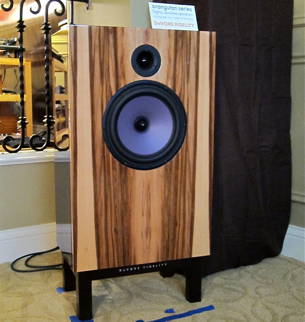

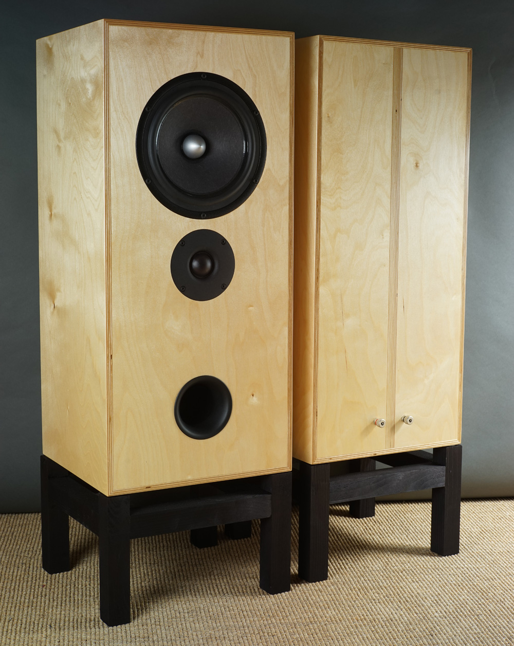

Size and proportion-wise, I have a very audio-involved wife who to her great credit does not inflict size restrictions on me. So I don't mind a slightly bigger enclosure like that of an AUDIO NOTE AN-E, etc. Hopefully my speaker will end up looking something like the 8008 CORNER model or a DEVORE ORANGUTAN as shown in the photos below.
(But without the port.)

The cabinet for the TARKUS project would be beyond my capability.
For ease of fabrication, I'd much prefer to make a mostly classic rectangular box speaker - similar in proportion to the AUDIO NOTE / DEVORE . 8008-CORNER models, the images for which I included in the my post.
(I far prefer their look also...)
