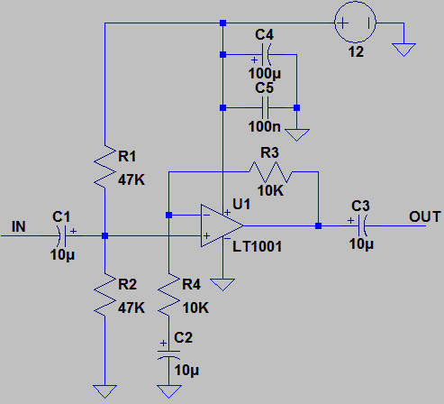

An age old issue I've been trying to deal with is driving music through the aux jack on my 2008 BMW 328xi with my Galaxy Nexus which does not produce loud enough of audio; annoyingly the aux and 12V power jack on this car are located in the center compartment where there isn't a whole lot of space to put anything big. (most longer car plugs will prevent the compartment from being able to close) I tried using a bluetooth receiver from Griffin ( Amazon.com: Griffin Technology BlueTrip AUX for iPhone and Smartphones: Cell Phones & Accessories ) and it was perfect form factor-wise but it was even quieter than my phone and it also completely killed the bass so I returned that within a day.
The only product I've found so far that matches the overall objective is: 12 Volt Boostaroo Revolution® Audio Amplifier & Sound Enhancer
I've been trying to look around and see if there is anything I can either buy or DIY - any ideas?

Yea for a DIY solution a power amp isn't needed as you only need a bit of gain for the aux jack - my visualized solution would probably be something like the following:
Power: Isolated DC-DC dual output (+/-) converter with 12V cigarette lighter input
Amp: Something like a CMOY essentially or an Objective2 with 3.5mm input and output; Voltage Gain ~5

Here's what I ended up making in order to power a cMoyBB off of the car's 12V cigarette lighter receptacle.
I get a nice, clean, and isolated 12V to power the cMoyBB with a voltage gain of 5 which amplifies the aux input nicely.
