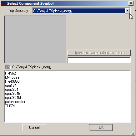

Actually I could have been clearer with the post with the attached zip file.
I actually create a separate directory for each project I work on. It is in that directory that I put the .sub and .asy files. I do not add them to the system library paths.
When you go to add the component you click on the little drop down for the component location and select the directory which you are in. The models then show up so you can pick them. Screen shot shows different models available in my synergy directory.
One of the benefits of doing it this way is that the project is completely portable and will just work on a completely vanilla install of ltSpice (at least ltspice IV)
Tony.
