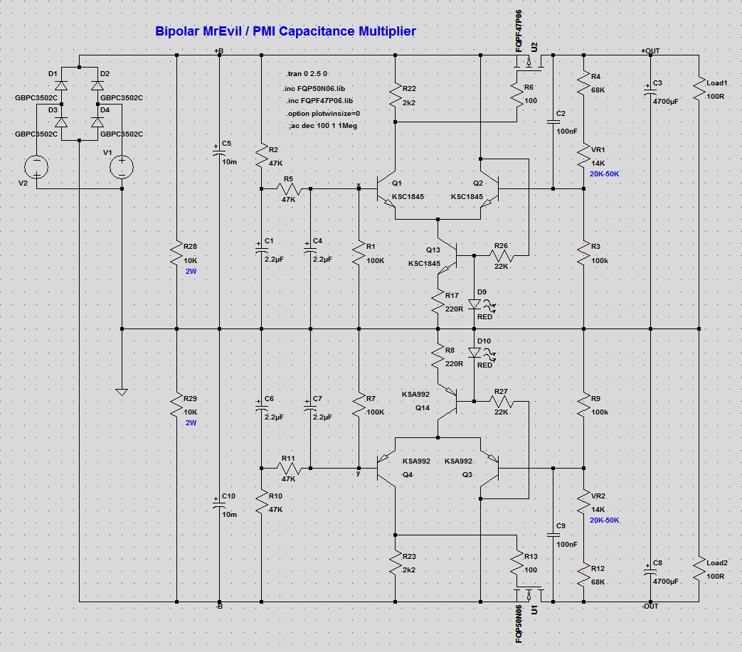

Elvee,
Any opinion on this arrangement:

Elvee,
446038d1414720404-simplified-mrevil-pmi-capacitance-multiplier-capacitance-multiplier-schematic.png
I built an example of this and found it works quite well. Operating the MOSFETs common source instead of as a follower let's you get arbitrarily close to the rail you are filtering, within the limits set by the magnitude of the ripple.

Elvee,
I wouldn't classify this as a simple cap-multiplier, as it incorporates a global FB loop.
I would call it a reference-less regulator or something of the kind
