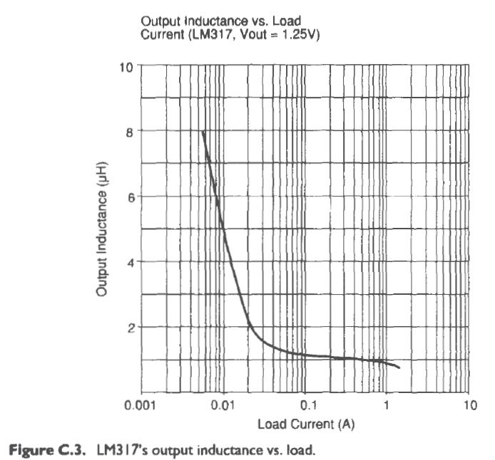

Quote:
Originally Posted by Gopher View Post
Tony
Have you taken into account the fact that the o/p inductance of the LM317 reduces significantly as Iout increases? I think Erol Dietz's measurements of resonant frequencies were for a datasheet implementation of the LM317 circuit with 5mA or 10mA Iout, but doesn't your circuit have a larger Iout and therefore a lower o/p inductance?
Actually Dietz' paper covers this as well
Click the image to open in full size.
- so beyond about c. 50mA I'd expect very little change in the modelling ( - as I posted above)
NOTE - this graph is at 1.25v out, i.e no 'lower' R to 0v for voltage setting. That means the graph only holds if you use the optional Cadj bypass cap at higher voltage outputs (Yes, using this cap drops the effective output inductance at higher voltage output. Obvious once you think about what it does)
I have sometimes deliberately added power resistors to '317 regged supplies to push the total draw toward or well past that 30-50mA mark - on low-demand items when the raw supply / heatsinking will comfortably support it. Sometimes it seems to help by measurement, even audition.
Similar things are true of more complex regulators, too: it seems mostly to do with re' and beta in the output pass transistor IME.
