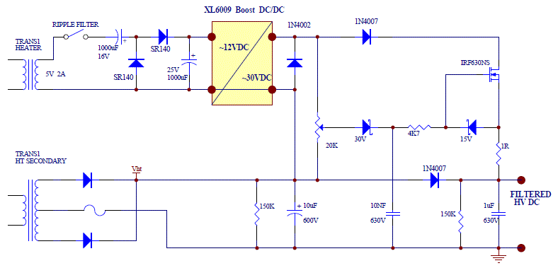

Referring to the simplified schematic, the combined voltage of Vht + Vcomp is used to charge the output B+ capacitance and maintain the load current. The FET dynamically regulates the B+ voltage to the peak of the Vht waveform, plus a small bias voltage to overcome the FET Vgs required for FET conduction. During steady-state operation, the series diode D1 stops the Vht capacitance from directly charging the output B+ capacitance, as B+ is normally higher in voltage than Vht. The reference capacitor Cref is charged by the zener diode Z1 to the max peak of Vht, plus some additional bias, and is only discharged when the min peak of Vht reduces to a level lower than Vref minus the zener voltage.
To fill the Vht ripple troughs, Vcomp and the Z1 voltage need to be at least the peak-to-peak ripple voltage. Vbias is about 4V for a typical power FET plus Z1 diode drop. The FET only needs to work at the Vcomp voltage, as protection diodes avoid any higher voltage stress. The FET current is negligible for a modern power device, so as small a device as practical is preferred to limit junction capacitances.

The example circuit below is my only prototype so far, and suits an amp with up to about 35Vpp ripple (ie. about 9Vrms). The Vcomp supply uses a capacitor input doubler, as that provides a common terminal for Vht and Vcomp. For the 5V heater, the doubler output needs further boosting using a XL6009 module – the module output is regulated, and can accommodate a wide input range from the doubler. The 15V zener for FET gate protection also acts to discharge Cref after turn-off. Some series resistance with the FET source can provide current limiting if needed, although that will add some residual ripple voltage depending on output capacitance.

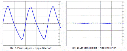

When the ripple filler circuit is on, the DC level of B+ will increase by about Vpk(ripple). With a suitable load, the example supply had 8.2Vrms original ripple which reduced to 150mVrms with the ripple filler circuit active, in which case the B+ level increased by about 12VDC. The ripple voltage waveform on Vht is close to a sawtooth, so the pk-pk voltage is about 2x sqrt(3) x the rms level. The Vht rms ripple level also increases a bit when the ripple filler circuit is active due to the constant power output characteristic of B+. Note that the ripple filler does not regulate the output voltage, and the intent was to allow natural sag to occur.

There are definite similarities with a capacitance multiplier - its unregulated, and the pass device dynamically regulates a ripple input voltage to a voltage just outside the pk-pk ripple waveform. The ripple filler increases the output voltage to above the ripple waveform, whereas the cap multiplier decreases the output voltage to below the ripple waveform.
A difference is the pass device is isolated from seeing the full input or output voltage, and so can have a relatively low voltage rating compared to B+.
Another difference is the reference signal is acquired somewhat differently - its not an RC filtered signal with RC time constant, but more like a sample and hold, and so there isn't any inherent 'capacitance multiplying' character - the output ripple is determined more by FET transconductance.
I think the protection aspects will be more robust, as shorted output is passed through a power diode.
