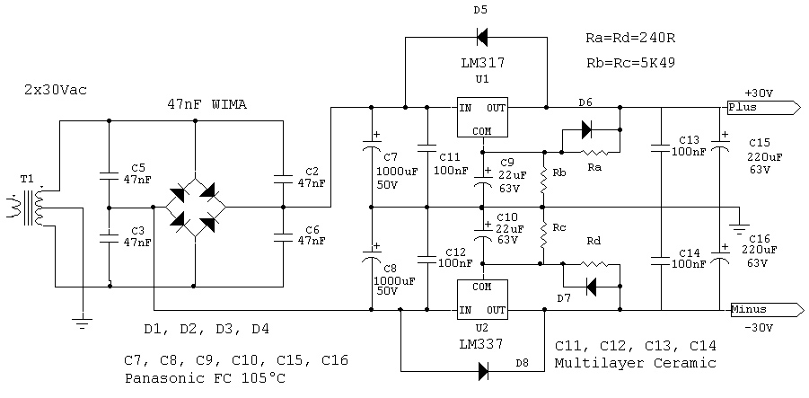

I use a Pass-based "Promethius D1" I/V. Dunno how similar that is WRT your B1, but I've noted some strange behavior in the Promethius PSU:Most amps work brilliantly with good CRC or CLC supplies. My experiments with the Pass B1 showed virtually no improvement between a good CRC supply and a full blown Salas Shunt Reg.
http://www.diyaudio.com/forums/atta...1-i-v-stage-pass-dac-pcbs-sale-d1ivstage1.pdf
The LM317 runs quite a bit warmer than the LM337. Sound is okay, for the 1st 15min, but then sounds "tired". The lethargy does not worsen any further, but I'm at a lot as to the root cause. I've replaced about all components but I'm all outta ideas. Maybe the SMPS you suggested will fare better??

Can't say I noticed a "tired" sound when using an LM317T.
