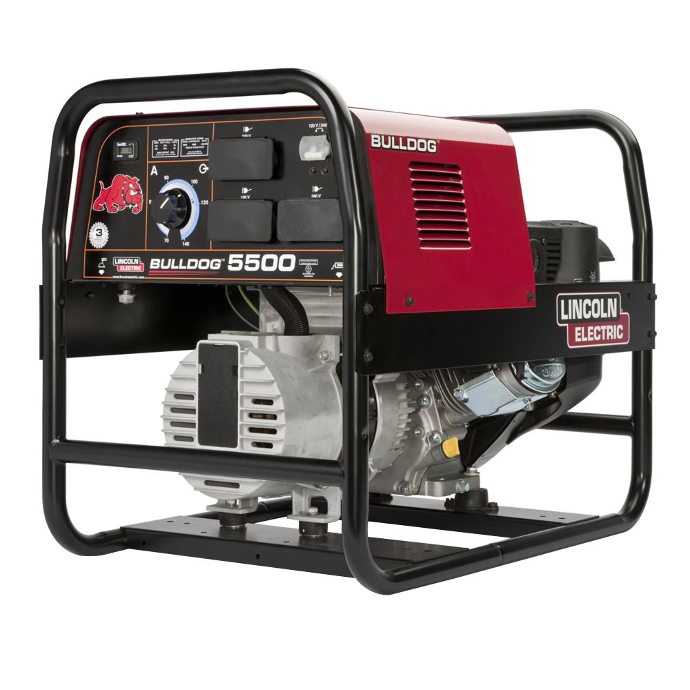

what part of generator don't you understand?
Click the image to open in full size.
anyway, who cares, he already said he had 80-200v DC to work with... doesn't even matter where he gets it from
200v seems to me, a bit high for buck, can you somehow limit with generator to 200v or below 100v?
full bridge might be the way to go instead of buck...

He means a gasoline-operated engine that runs an electric generator that outputs "standard" 120VAC.
