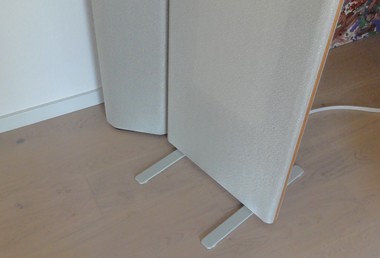

Hi
For 2 month ago I received my beloved Magnepan 1.7 but from the start they needed some assistant in the lower part.
Then I designed a line source dipole subwoofer:
4 x Peerless SLS 400 – 830867 pr side. And I used the sidewalls for the outside baffle – see picture:
Click the image to open in full size.
To get the same finish as the Magnepan 1.7 I orderd two “Socks” directly from Magnepan – great service and in a week I receive them here in Denmark !

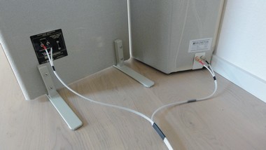

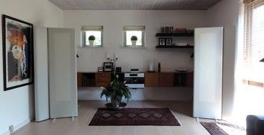

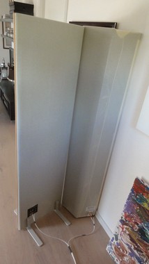

More pictures:
