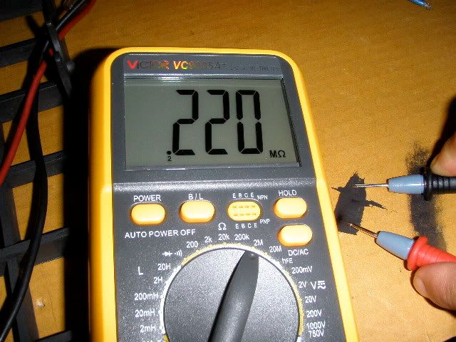

The hexagon stators certainly look nice. But they might not have the hole size that you like to have. Here in Thailand, the smallest hole I can find is 6 mm and I think the holes are too big and the open area is too much. The efficiency is therefore quite low. I now have to use 9.6KV of bias voltage for my panel with 3 mm spacer to sound loud enough for me. I use 1:150 transformers and a 300 watts class D amp.
I'm thinking of using black ink to draw a line for biasing diaphragm instead of using copper. In my experiment, the conductivity is not too bad with this ink. What do you think?
