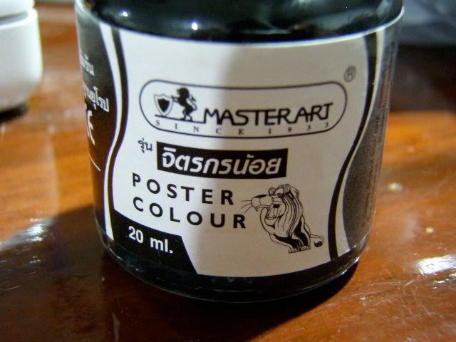

Hi WrineX,
Please look at the picture of the ink bottle. I'm not sure if you could get this particular brand outside of Thailand though.
But, I'm very sure that any brand of black poster ink will be fine. My friend in Taiwan has tried a bubble jet printer's ink. And it is good too.

When I tested the first sample, part of the ink was still not completely dry. You can see from the picture that lower left side was still a little bit wet.
I've just tested the same spot on my first sample again. The ink is now completely dry. The resistance is down by 10 times of my first measurement result. It now only measures around 20K ohm.
This is to confirm again that the black ink does contain carbon, or other conductive stuff.
Wachara C.
