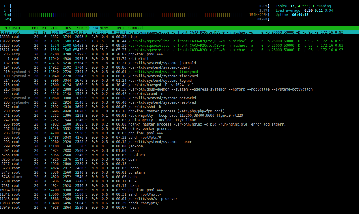

Normally I can play for hours (really a joke) but It's a long time DOP on the Chord without issues.
I'm monitoring in cron every min to see If something unusual is happening.
Top

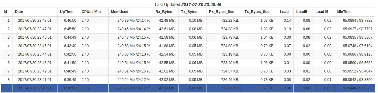

cronlogs every min
Quite rocket science but things need to be right for DOP over network with the Chord 2Qute.
Top
cronlogs every min
