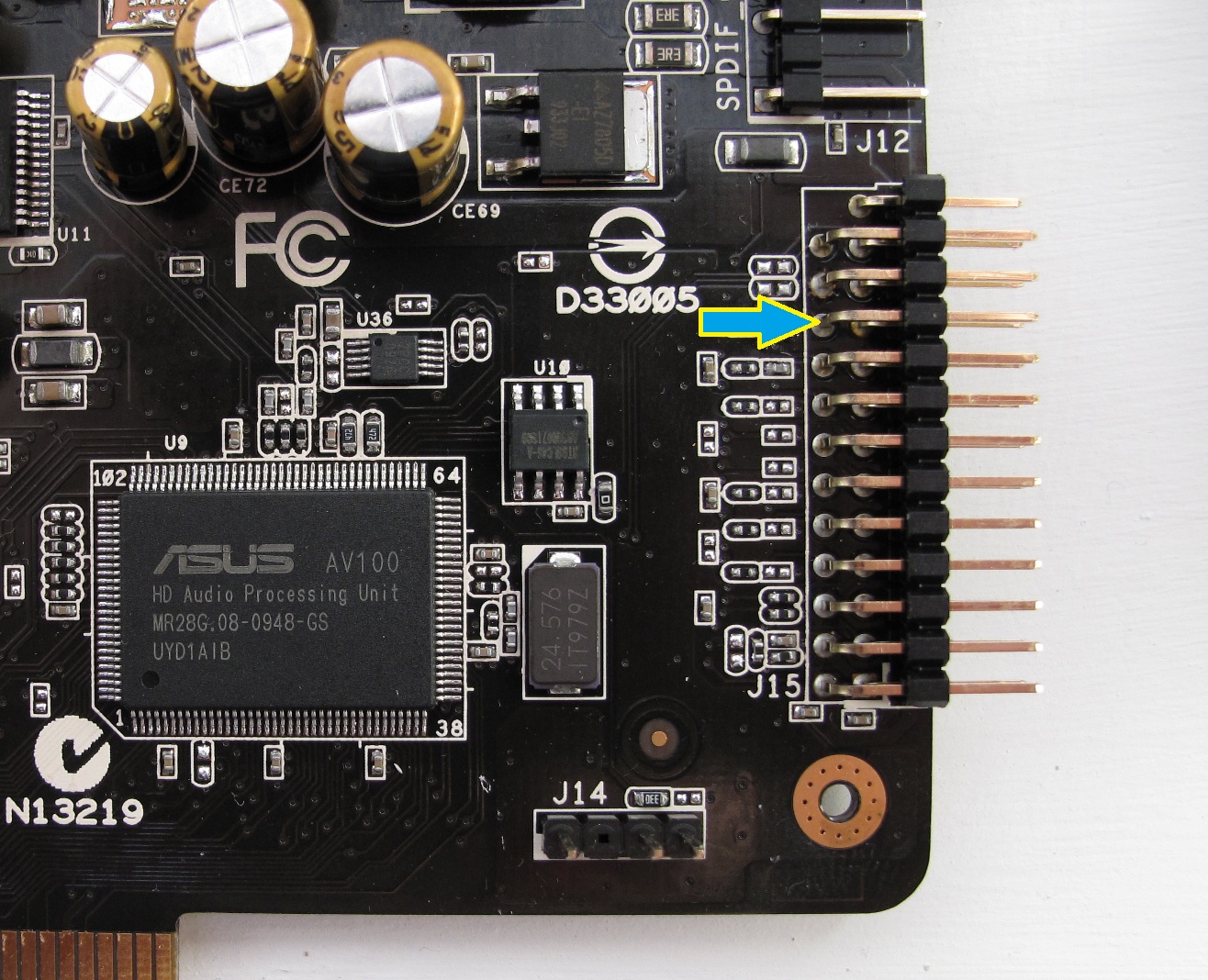

Hacking the I2S lines.
First off here's a picture of a section of the ST card, showing the AV100 chip, header and a few of the surrounding chips. The crystal oscillator is obvious, the CS2000 chip is the small 10 legged thing above and on the right hand side of the AV100.
The arrow indicates the pin that carries the master clock. The pin below it carries the bit clock and the pin below that carries the LR clock.
Now for the data line
The easiest and least invasive way to tap this is via the reverse side of the card.
The picture here shows a wire soldered onto the correct 'via' that goes from one side of the board to the other. This is almost directly behind the PCM1792 on the front side so you shouldn't have too much trouble locating where this is at.
Above the via I simply scraped off some of the board coating to reveal the copper ground plane beneath and soldered the shield directly to this.

Which Asus card are you showing? I tried looking at the Asus site but its a mess to get any details from.
As I said they must use a PLL at a minimum to create the 44.1 clock chain. There is no direct way to generate the other clock chain. PLL's can be good but they are very hard to make very low jitter. Done digitally in a chip makes it extremely hard to do. The biggest challenge is close in jitter, below 1 KHz. Low jitter (low phase noise) at low frequencies requires a low corner frequency and long settling times which are difficult for a product like this.
Does your M Audio output SPDIF at 176.4 KHz? When I last had one (years ago) it didn't support that sample rate. None of the other cards using the Via chip that I have looked at support 176.4 directly. Via has acknowledged this issue to me as well.
Ah you were referring to S/PDIF. I have no idea if the Maudio can, if the Juli@ needed something special to make that happen then I doubt the Maudio did.
It's the Asus Xonar Essence ST.
I've wired the scope up to the ADC output clock and it appears the CS2000 multiplies the clock by x2 to produce it's master clock.
I know that the PCM179x series of chips do not require the master clock to be in phase with the other clocks, so this makes sense, however...
I thought the point of replacing the clock in a CD player with a much better device was so that all the digital circuitry functions from that 1 very accurate clock.
In other words the creation of the bit clock, LR clock and the data stream would all improve as a direct result. Is this not the entire story?
I can see how providing a slightly better master clock to a DAC chip alone could maybe improve the sound quality. But if the Cmedia chip, that generates the bit clock, LR clock and data lines, is still generating them based on its own internal PLL, wouldn't half of the point of using the CS2000 be wasted? Or does simply supplying the DAC with a good clock sort all of this out?
Reading up on the CS2000 suggests it a very interesting chip. The two inputs make sense if you have some inderstanding of the core function. The frequency reference is the low jitter/noise master clock the PLL reference its output to. The frequency reference is used to determine the desired output frequency. Think of it as a frequency counter that passes a number to the pll to set itself to. The combo speed the lock to a specific frequency. Still the lowest jitter is listed as 50 pS RMS and 175 pS wideband all above 100 Hz. Those aren't bad numbers but a crystal can be significantly lower. The part is really targeted at multimedia applications where you need a lot of frequencies for video.
Do you know of any other products that would be more suited and work in a similar-ish way?
And I suppose would it be worth it?
I think the CS2000 is a good solution for this as its an "any rate" synthesizer so it can generate all the necessary clocks. Depending on the DAC chip architecture either the master clock or the bit clock are the critical clocks that the samples are referenced to. The Cmedia chip must create the other clock/data signals for the i2s interface since they are deeply married to the internal logic. I suspect that the cmedia needs the master clock to run and the CS2000 generates the other clocks (much like the fpga on the Juli@ card does).
What I would do to make a significant improvement on this (without major surgery) is get the supply noise on the critical logic as low as possible. It translates directly into jitter even on digital logic. Pulling the I2S out will get better performance than spdif can, but ideally a phase locked crystal at the input to the dac will help (if you can work around the sample rate switching issues). Fortunately PC sample rate converters are synchronous so once locked to a clock they will stay locked. The Jitter from the CS2000 is lowest at certain frequency ratios (see the datasheet for the math) so probably a multiple of 48 will give the best results. However don't expect the PC sample rate converters to be perfectly transparent.
The CS2000 chip in this instance generates the master clock directly and feeds it into the master clock input on the DAC chip. That is it. Nothing more nothing less.
By this I guess you are referring to the power supplies that feed the Cmedia chip and the CS2000?
I will have a look into how easy it would be to power them from their own power supply. I think the Asus card simply uses the power from the PCI socket. At least I haven't seen any 3.3 volt regs anywhere on board. I've got a 3.3 volt super regulator for supplying my PCM1794s anyway, so a low noise supply is close by.
This is unfortunately the problem I have run into before when looking into reclocking. I want to keep the ability to swap sample frequencies on the fly.
Although having said that a single 24.576 master clock would work with 48, 96 and 192khz.
