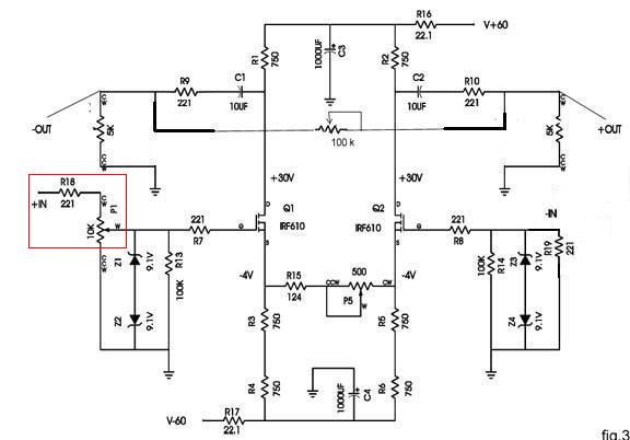

I'm gonna run a BOSOZ unbalanced in/balanced out and hopefully someday feed a nice pair of Aleph 2 monoblocks. Anyways what I'm concerned with is how I terminated the negative input, I did a search and I believe this is what Nelson recommended.
The other main question is with regards to the portion of the circuit in the red box. I'd be using this pot as an input level trim with one of these (dual gang) on each input either before or right after the switching relays. Am I correct in thinking that this would work? I'd like to be able to use only dual ganged pots in my circuit for simplicity's sake (trim, gain, and volume). Any other suggestions for tweaks I'm getting real close to ordering up the parts.
Thanks!

Voume controls must be after the relays. And its better for you to use them on the output. because you will be lowering noise too at low volumes..

Why is it that volume controls have to be after the relays? The pot on the input will be used to adjust for the different input signal levels depending on the sources used. To make the input signals all approximately the same level so that switching from say a CD player to a computer output doesn't dramatically change the volume.
I'm still gonna have my main volume control on the outputs. As discussed in this thread.

If you are using separate pot for each input it doesn't matter where you place the relay. If you put the realy before the pot, the pot might load your source but i don't think it's a problem.

Thanks Peter, that's what I was thinking. It seems cleaner to me to put the pots before the relays, and then I don't have to worry about anything placing an unwanted load on the source.
Does it look right how I did the negative input? I'm pretty sure it's o.k. just need some reassurance.

The negative output looks OK. Actually you have to put pots before relays, otherwise they will all load the input of your preamp. I didn't thought about it initially.

If you will use separate pot for each input then they dont have to be after relays
And ground the negative input..

And if you want unbalanced in to balanced out, there will be losses on undriven side and you will have unequal voltage on + output and - output so I suggest you that you install constant current source as discussed in this thread opened by me because I had the same problem with unbal -> bal.
You have 2 options, mosfet ccs or bipolar ccs, I chosed bipolar because it sounds better.. Its wery easy, just put enough heatsinking on transistors.
