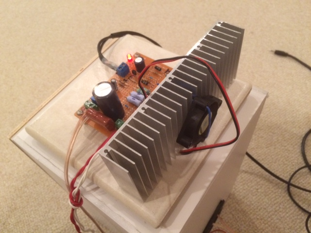

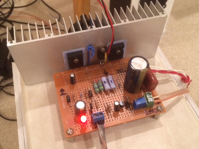

Your ACA looks way cool (and probably runs way cool too). You probably have overkill on the fans - hope they are not too noisy.
As you saaw, my experiment showed that a single tiny 40mm fan is sufficient to cool two mosfets. The small GPU fans are supposedly quiet at 25dB.
It sounds very good with my XKi PA130 coax speaker. 🙂
