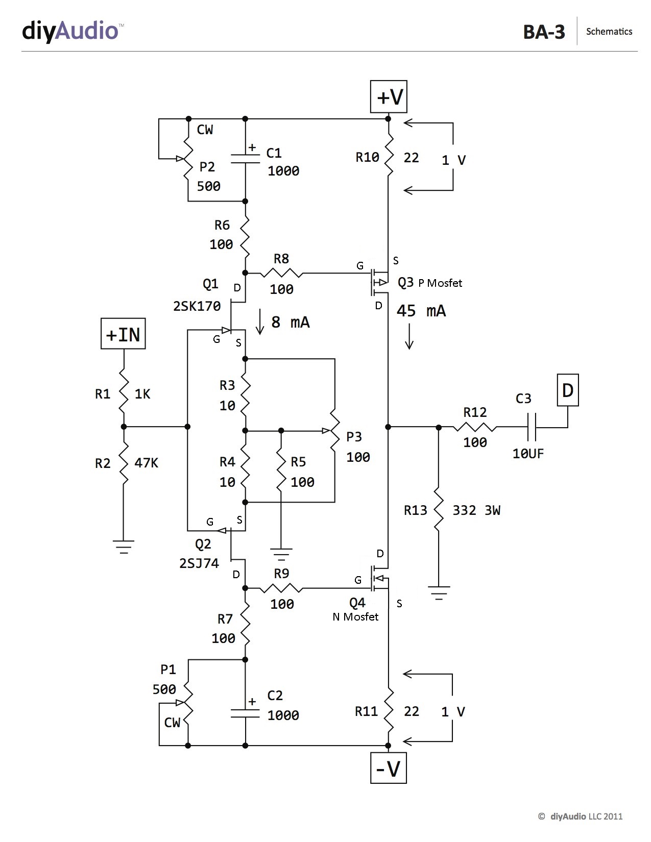

Using the BA-3 gain stage (“Front-end”) as a line stage preamp. A mini build guide.
PCB - P-BAGSN-1V20 - Burning Amplifier Gain Stage for BA-3 (Requires bias boards and output stage; Makes 2 channels; Rev 2.0) - Circuit Boards
BA-3 as preamp thread - BA-3 As Preamp
A club in Minnesota that used this preamp as their club-wide reference! https://sites.google.com/site/audios...3-preamplifier
The BA-3 front end is able to act as a wonderful preamp, with plenty of gain that is changeable with just a few resistors.
You will need a power supply, selector/attenuator, and chassis.
The chassis used in this build is the Galaxy 388 from the diyAudio store. Galaxy 388 (3mm Front) - Compact with Quasi Heatsinks - Chassis
Click the image to open in full size.
Schematic of signal circuit.

BA-3 gain stage (Front-end) PCB. Note that there are PSU connections (V+, V-, GND) for each channel.
Also raise resistors R10 and R11 as shown, you will need to clip test lead there to set this stage’s bias and DC offset.

Bias and setting of P3
Bias -
The procedure for setting bias on the BA-3 FE is almost identical to setting an F5, so this might seem familiar...
Adjustments (Bias and Offset, set with P1 and P2)
This is easiest with three DMM.
Shorting the input jacks is helpful, although not strictly necessary.
Before power up, dial pots P1 and P2 to 0 ohms . DON'T adjust P3 during bias
Place one voltmeter (Set to DC volts) across R12 - to observe DC offset
Place a voltmeter (Set to DC volts) across R11 another across R10.
For test - slowly dial up Variac ( presuming that you have one , as man with many skills) up to full mains voltage , observing rail voltage at PSU ....... thinking about max cap voltage ( 25V as in FW ? ) , because with 0 Iq PSU is unloaded and voltage is maxed (It’s useful to have another meter for this…) If nothing is smells bad, and the magic smoke is still in the circuit - leave Variac at full mains ;
IF you don’t have a Variac, you must build a lightbulb mains lead. (with a 25W bulb)
What's important - Iq (measured as the voltage across source resistors; the Mosfet bias) must be very low , offset is irrelevant in this moment .
Now turn one pot one turn ( assuming that you have multiturn pots) then turn other pot one turn. Continue, one turn at a time on each pot until something happens.
Observe voltage across resistors and output DC offset.
Proceed one then second pot , again just one turn
Observe Iq and offset
Again one turn + one turn
Now you are probably in range when you can see which pot is pulling offset in right direction - to 0 . It will feel like one of the pots is controlling the bias on both sides, and the other is controlling the DC offset.
It’s best to increase the bias a bit, and then zero the offset. As you zero the offset you will decrease some of the bias, so it will be two steps forward and one step back. That action is normal.
As you increase the bias and zero the offset, remember to always keep the offset near zero. If you run out of turn on the pots, determine your max bias, with zero offset. (It’s useful for troubleshooting)
Proceed iteratively with pots , while you set - say - 75% of desired bias, with zero offset. Remember, full bias is 1V across R10 and R11, with zero offset BEFORE the capacator. If you measure after the cap there should always be no DC.
Now - put lid on box and let it cook for a while - until you get thermal equilibrium on heatsinks
It's best to use wire/clips to leave those voltmeters in place ;
Open the lid , up bias to - say - 90% of desired one ,while maintaining offset
Put lid on , let it cook.
Check again.
If all is OK - move voltmeters for Bias and offset to other channel and repeat procedure.
Use it few days at 90% of desired bias , then check and set to 100%
Remember - temp. equilibrium with lid on is important.
Setting P3 - BEFORE installing and soldering P3 it’s best to adjust the pot so you have equal resistance from pin 1-2 and pin 2-3.
If you didn’t set it, determine how many turns the pot has. Run the pot all the way to one limit (they usually click) and then turn the adjustment the other way for 1/2 of it’s turns. (I.E.,if a 25-turn pot, adjust it 12.5 turns.)
Assuming well matched Jfets the neutral position is going to sound really nice, with 2nd harmonic dominant at most levels. IF you have access to a distortion analyzer, or a high-resolution FFT (or both…) give the amp a 1K test sine wave that outputs 3V measured at the output. Then adjust P3 as necessary for the harmonics you prefer. If you adjust for minimum THD, you will likely have nulled out most of the 2nd harmonic and made it 3rd dominant, which in my opinion makes it very fast and clean, at the expense of soul. YMMV.
Anyway, if you DON’T have a distortion analyzer or similar, take careful notes and turn the pot a few turns (or more) in whatever direction you want and see what it sounds like. It’s a subtle change, but I think you will sense something. You can refer to you notes and see where you like the pot the best. And if you ever get lost, set it back to neutral, (with the power off) just bottom the pot in one direction and set it back to 1/2 it’s travel.
