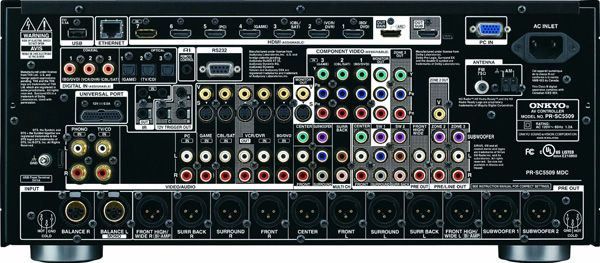

Onkyo's flagship preamp handles all that -- the PR-SC5509

Thanks for the quick reply, though the Onkyo seems a bit intimidating
