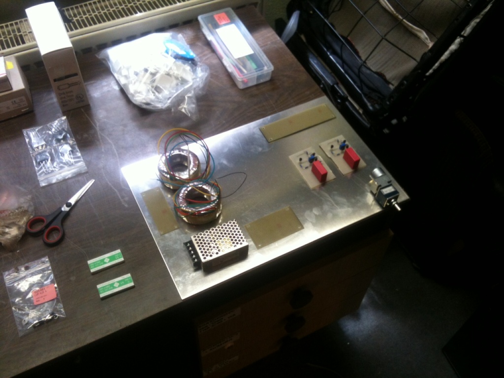

hi everybody!
my F5 mono's are working fine, so I thought I have to build a suitable preamp for them.
I use jumas layout for it.
http://www.diyaudio.com/forums/pass-...ml#post1690625
This time I'm building it dual-mono, both preamps in one enclosure with own r-core-transformers, supplys, relays, etc...
Controlled by an Atmega16 with 16x2 lines display. The menus are controlled by an alps encoder with switch.
Relays (and everything else like the supplys, etc...) will be switched by the controller, too... The software is ready and tested, now it's time to get all the parts together. ;)
The controller gets his own power supply, which also supports the relais, the leds, etc... (31 relais, about 40 orange led's)
It will have 5 inputs and 2 outputs.
enclosure-dimensions: 430x280x50mm
bottom 3mm aluminium, top 6mm security-glass brown tinted
sides and front/back 10mm aluminium with all the holes for needed parts (display, volume + preamp control)

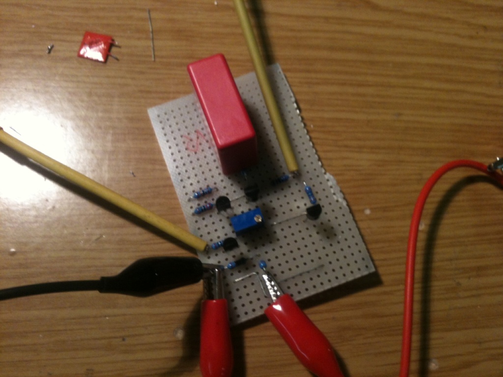

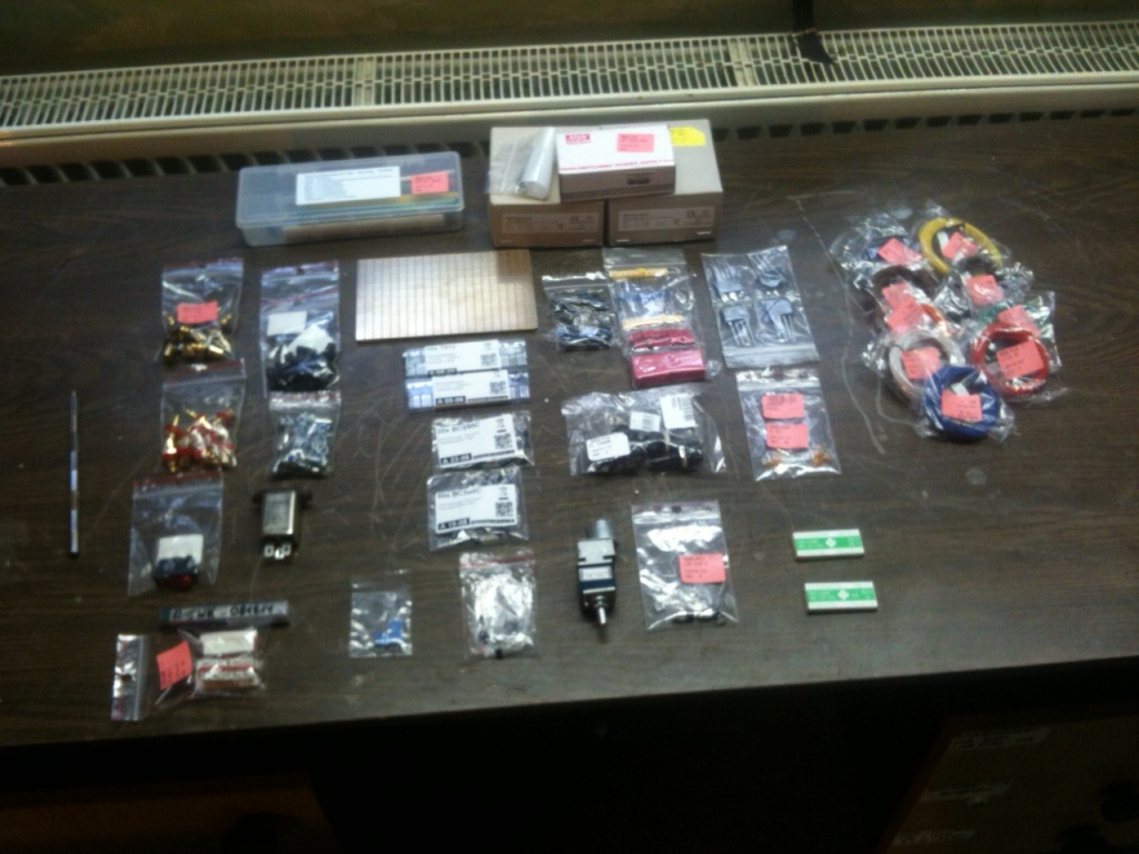

Here a few pics from the parts and first measurements on a demo-pcb:

GentryBa 7th November 2012 08:09 PM
hey juma!
hmm, I can't get the DC-offset under -310mV in my circuit.
when I turn the pot from lowest to highest, the difference on the ouput is +-8mV.
The parts arent matched, but could that bring such an offset?
best regards,
matthias
juma 7th November 2012 08:12 PM
What's the Idss of your JFETs ?
GentryBa 7th November 2012 08:18 PM
maybe a very silly question, but how can I get the Idss from them?
I'm not a bloody beginner, but not far from that. ;)
juma 7th November 2012 08:52 PM
Idss is Id at Vgs=0V (Vds=10V)
Please read this (figure 5):
http://ken-gilbert.com/images/pdf/er...y_on_jfets.pdf
