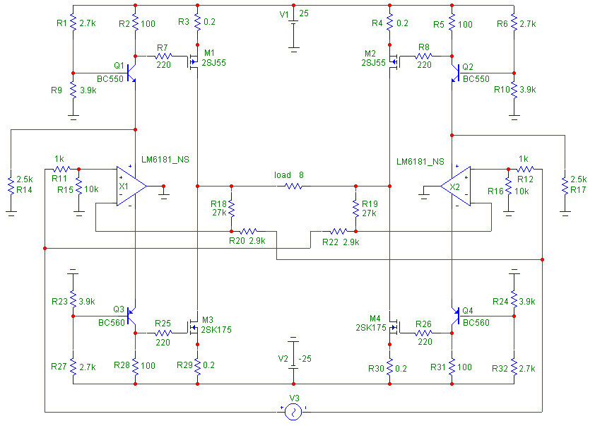

Today in the train while trying to understand the susy for the first time, I got some idea...
Just quick and dirty:
At the negative inputs of the op amps the clean part of the signal is much more attenuated than the distortion part.
Any good ?
Output impedance of the signal source is 0 ohm.

Nelson Pass said:The distortion will pass through V3 to the positive input,
and be reamplified, won't it?
Yes
I connected R22 to the noninverting input of x1 and other side same thing.
Then played with values to get full output swing @ 2V input.
Added a 5kHz sine source with 10Vpp and a 10ohm series resistor and connected that parallel to the load.
This is my distortion
With PSU switched off in the sim this gives a 5kHz 4.5Vpp sine across the load.
With PSU switched on and inputs shorted the 5kHz sine is reduced to 50mV. 🙂
-40dB ?
The 5kHz sine across the 1k input resistors is 160yV.
What does this want to tell me
It is also very nice to see in the sim how the opamp output (if a 10ohm is added on the opamp output) works against the external distortion
