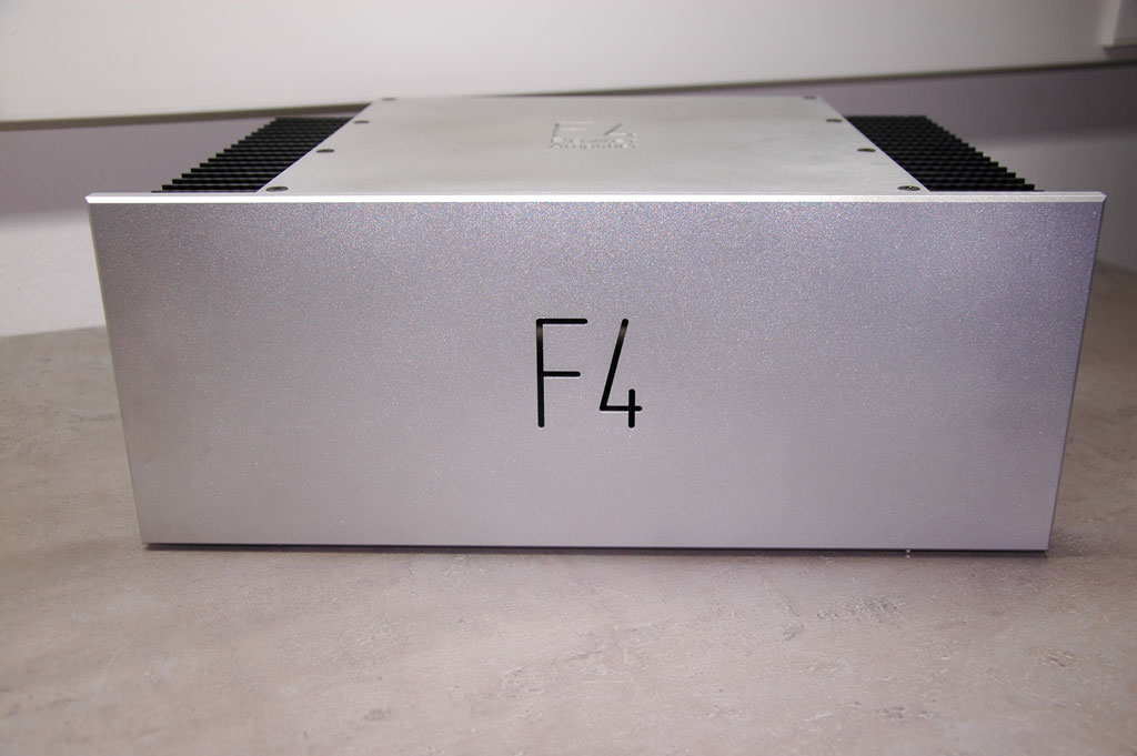

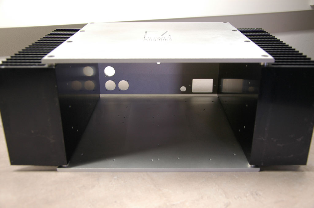

The concept is straight forward – the case is built around the heat sinks, they are 300x150mm (Fischer KL-271). If the heat sinks are the sides we obviously need 4 other elements – lid, bottom, front and back. Front is 10mm aluminium, the other 3 parts are 6mm. Everything is CNC machined, shot blasted (glass pearls) and anodized. Not painted etc.. There are washers between the bottom/lid and the heat sinks to allow air exchange. The principle is copied from Chris “Elfenreiters” cases who is also one of the two guys who organized the PCB group buy etc.. You can find more information in the thread in the German Analogforum here.
Here are the pictures of Chris’ cases (registration required).
In the same thread you will see some pictures of my cases in different stages of “production”.
E.G. here after shot blasting before anodizing:
Click the image to open in full size.
So – the concept is stolen (), the details like engravings, bevels, logos, exact sizes etc. have been drafted by me and executed perfectly by a guy I know. I think this really makes the difference – it’s basically done perfectly. It’s not easy to get this kind of perfect result no matter how much money you are prepared to spend. You need to find somebody (or be somebody) who not only has the technical capabilities and skills but also really cares.
Best Regards
Sven
PS: I do have nightmares about accidentally scratching it!
