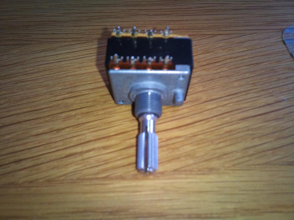

Hey. I have a Pioneer A-616. And the volym Pot its broken. Its a log stereo pot with 4 terminals on each side. I have only found pots with 3 terminals on each side.
The name of the pot: ACW-136-A 726l 60K x2
Picture:
Thanks Rasnaz..
Picture:
Thanks Rasnaz..
One par of terminals are L+R Loudness connection!
Regards zeoN_Rider
How do i know which it is?
i need to replace the same volume pot on the same pioneer a-616 amp. can any body help find a replacement or can the OP confirm if the fix worked?
I've seen Alps pots with the loudness taps in just the last couple days, but can't remember where exactly. Try Dantimax and of course Ebay. They won't be exact replacements though, have you tried cleaning them?
