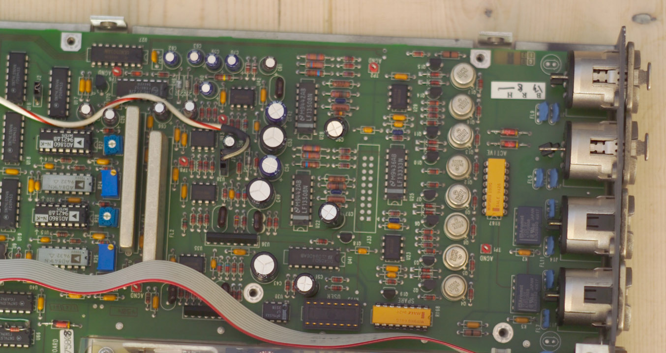

There are Neutrik XLR connectors with pins soldered into the pcb and connectors are mounted on a plate. It is not possible to remove the PCB without disassembling the connectors.
The plastic parts have to be pulled out of the outer metal parts.
How is that possible ??? Any trick ?

In a plastic part there is a hole for a flat screwdriver. You need to turn the lock and the metal housing will come off.

The 2 pc D-Series connectors consist of an insert and shell, this allows soldering the insert onto the PCB and locking it into the shell afterwards. In the middle of the insert is a hole with a slot.
Using a ‘00’ size flathead screwdriver (part # SD-1) it is possible to lock/unlock the insert in the housing.
Hehehe Peter beat me to it
