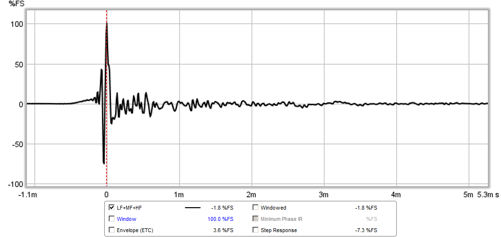

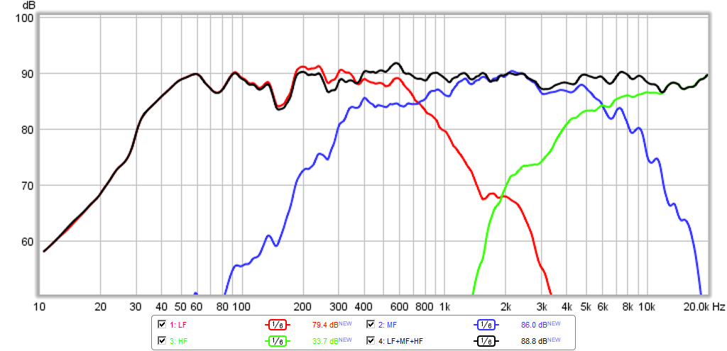

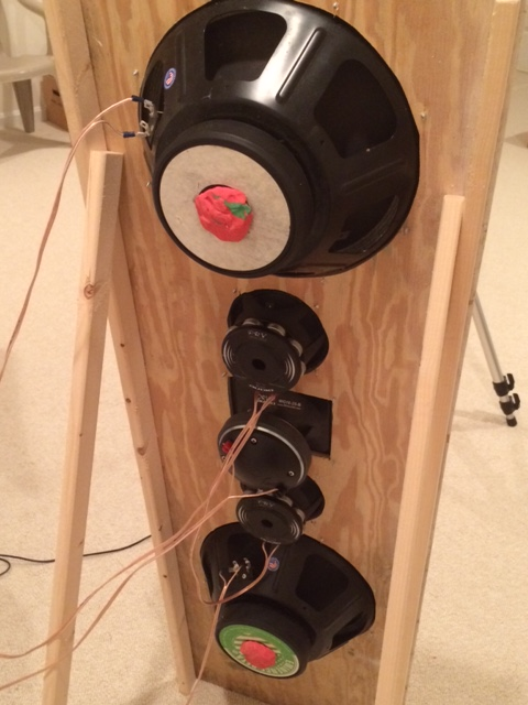

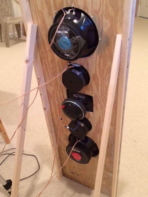

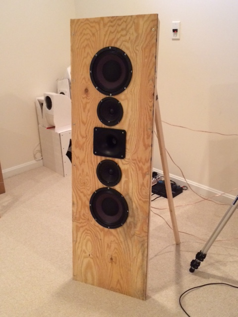

B&O with Beta 12cx, 5MR450NDY, D280Ti
I swapped out the woofers for the Beta 12cx to get some real bass, while I was at it, I decided to swap the mids to the higher sensitivity 5MR450NDY. Both the woofers and mids are now wired in parallel (4 ohms nominal) in order to boost sensitivity by 6dB for same voltage.
Here is what it looks like:
And after some initial quick and dirty DSP settings adjusted (delays and very minor EQ) we get this for acoustical crossover. I am using the mid in a wide mode in order to keep the mid in the telephone band without a XO.
Here is the XO setting in miniDSP:
Here is the impulse response:
Here is the step response:
Still listening to it now, so far so good.
that looks strong - how does it sound to you so far? what is the impression of the higher sensitivity mids vs PA130?
Pretty good starting point xrk971. Have you tried hammering the drivers into close to perfect slopes using the miniDSP EQ?
It sounds much cleaner than the PA130-8 which has a lot more breakup peaks in the 5k area. The system is indeed "strong". After building it and looking at how intimidating it looks I realize it is a bonafide pro audio blaster. Two 95dB sensitive woofers, two 95dB sensitive mids, and a CD and horn capable of 108dB. On paper it should be about 101dB at 2.83v and 4ohm system.
I got to listen to only several tracks so far and recorded them too but have not had chance to post yet. The sound is very good - balanced overall as can be seen from frequency response. As expected it sounds good with all genres. The TG9FD-DC28F-TG9FD combo seems to have slightly better articulation of the upper registers - but that was because the system had more of the HF's handled by the soft dome. But this system has a lot of reserves left over as the drivers are able to still take on a lot more power. Acoustic guitar realism and attack is still sure convincingly realistic. Eric Clapton's "Unplugged" is rendered very well.

I believe it is too Strong for my little listening room 🙂 it integrates well even at 1m away. The CTC distance from mids to tweeter is not too big. The big woofers are low passed at about 500Hz. The pre ring is probably the tweeter CD diffraction off the hard edge that is not flush. Still trying to debug that. If you notice Dunlavy surrounded his tweeter with little strips of open cell foam.
