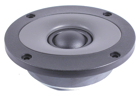

I'd like to see what people have done. I just bought a pair and going to be building a ported 2 way speaker.
I bought a pair of these.
http://www.madisound.com/cgi-bin/index.cgi?cart_id=6239969.18461&pid=1935
Outside diameter 103.8mm
Cut out 73mm
Depth 24.5mm
25.4mm = 1" = 2.54cm

Davis driver
I know both of them. The Davis is too expensive forwhat it worth, but still a good driver, limited application though. Their high Q (0.4) makes them only suitabe for larger Bass-reflex design. It's not totally dry, but pleasant sound. The tweeter is a Seas, very nice device.
IfI would have to choose, I'd take a Scan-Speak 18W/8546 drivers, which requires small enclosure, has also a Kevlar diaphragm, but it's adream of a speaker.
- dan
Curmudgeon said:
Is the Kevlar coated, (like the ScanSpeaks) or is it bare? If bare, I've seen some uncoated Kevlar cones break up quite harshly.
Any Kevlar diaphragm is coated, because if not it wouldn't be airtight. The Davis speakers are not heavily coated though, just a latex-like layer, and also the Scan-Speaks have a more refined coating. To decrease the peaks try the "Sound Varnish 'D' " coating, which brings excellent results (distributed by Strassacker - see www.lautsprechershop.de/hifi/daemmen_en.htm). Don't use the one without the D suffix (D= damping, for Kevlar, Glassfibre, Alu cones and sometimes carbon cones/ domes), this one is designed for paper and fabric diaphragms.
